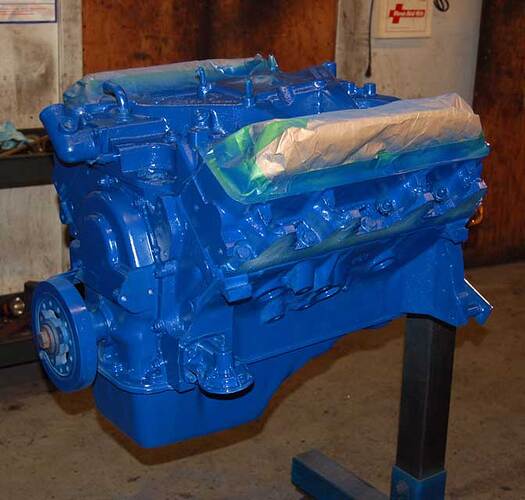

^^^ after researching and reading, I decided to go with the NPD paint. Can’t recall exactly what the deciding factor was and I didn’t do a comparison with VHT.
To my eyes, the NPD looked bright when it went on but it darkened up as it dried.
As for durability - I’ve only driven a couple hundred miles since reinstalling the freshly painted engine - but so far so good.

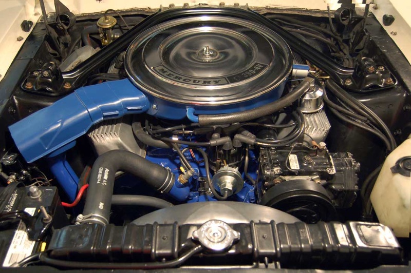

Attached are a few pics. The air cleaner base and G snorkel were already painted by a previous owner and I haven’t repainted them yet with the NPD. They are a pretty good match, just a smidgen lighter - but I am going to do a little repair work and paint them with the NPD product.

Thanks for the pics. That helps me make my decision.

Philip your engine and engine bay looks great. That Ford blue really pops!
Thanks Steven -
It is a very “amateur” restoration. I just wanted it to look decent. I am going to drive the snot out of this car so whoever gets it next is going to have to restore it again anyway. Or would that be “re-restore” ![]()
Some of the items hanging off the engine weren’t supposed to be blue - I did remove and strip them.
Anyway, the NPD paint went on really well - seemed to be high quality and their product description reads:
PAINT, ENGINE ENAMEL, FORD (DARK) CORPORATE BLUE, NPD S EXCLUSIVE SPRAY CAN FORMULATION OF THE SUPER CORRECT PPG 13358 ENGINE ENAMEL, AN EXACT MATCH TO THE PPG CODE MAKES THIS THE MOST AUTHENTIC CORPORATE BLUE IN A SPRAY CAN!
