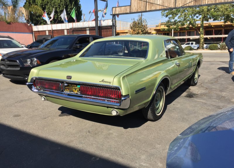

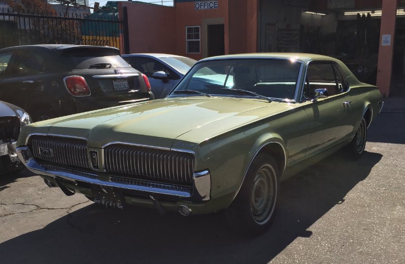

Some photos…

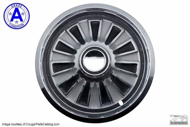

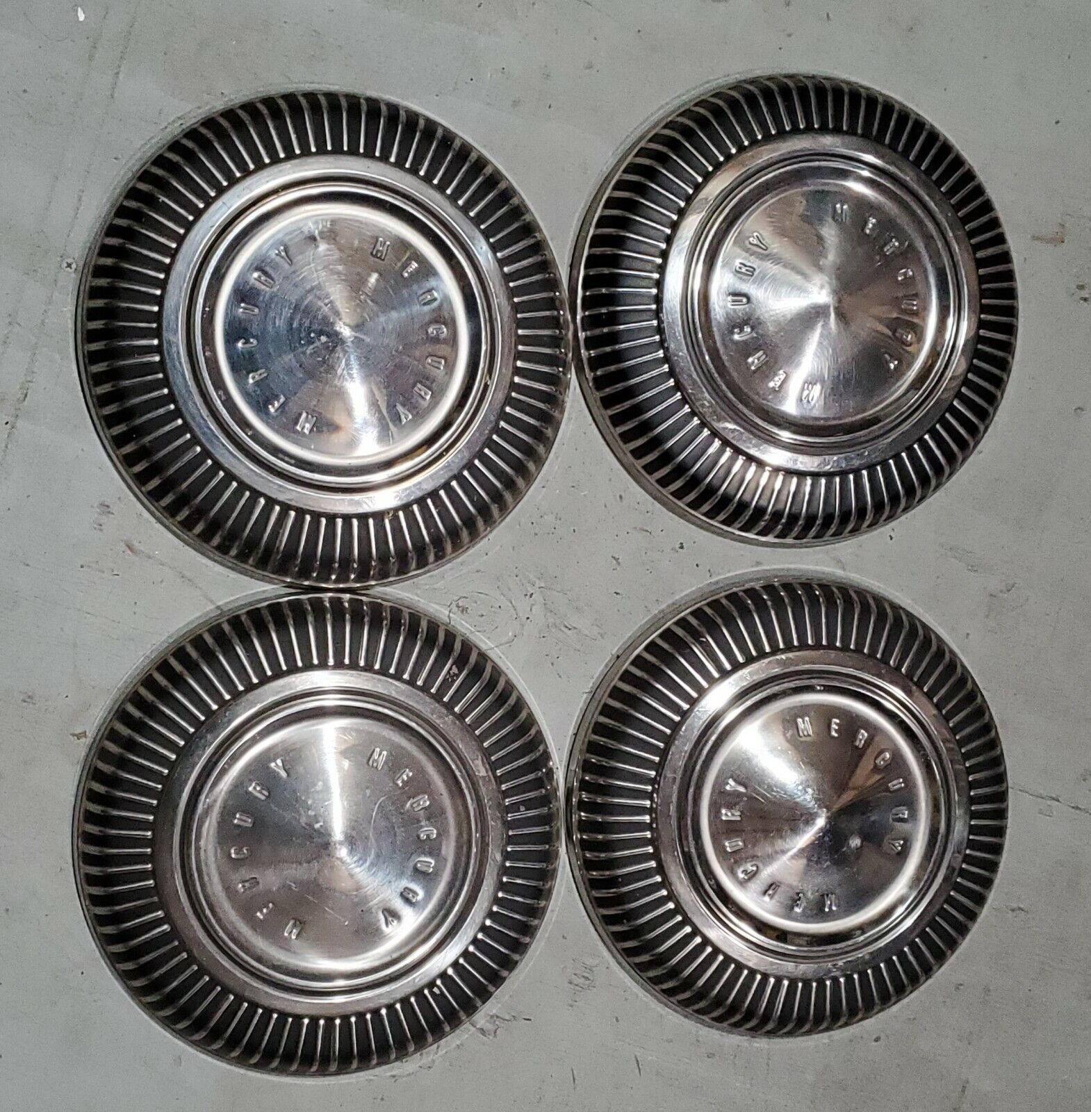

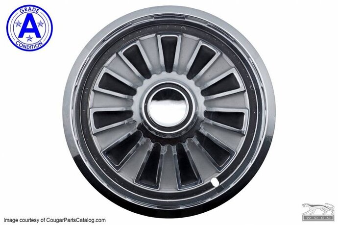

Wheels painted body color? Those were the base ones with small hub caps.
Like these that I have for sale on Ebay.
https://www.ebay.com/itm/363181517274
Those were the original wheels (less hubcaps) that came with the cougar. I have new wheels and tires on order, so those will go after the suspension replacement. The hubcaps that came on the wheels (but taken off) are like the ones pictured below:
