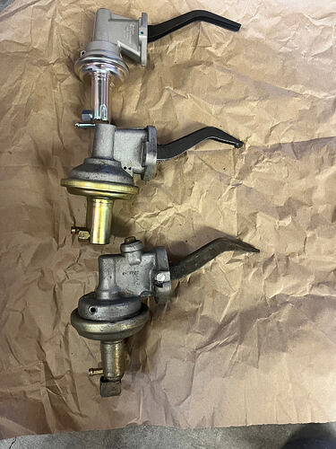

Probably going to be annoying but my fuel pump that I bought 6 years ago from one of our favorite supply house, started leaking. It was under $25 and looks very similar to the original Carter I took out.
So, I looked them up again and the picture shows the same kind I bought before. I ordered another one along with a rebuild kit for my Carter.
When I got it in the mail, it is a Delphi and looks nothing like the picture. Oh well! Go to put it in and it’s not fitting. I measure the arm and it’s 1/2 longer than the other 2, which are 4 1/2”.
I call supply house and they said send it back. I can buy this pump in my own town. Now I’m stuck with freight again.
I took some good advice about giving it a break so I slept on it.
This morning, I got the Delphi to fit by pushing a little harder. The spring was stiff. Changed the oil and everything works fine now.
It is annoying but they are lessons I need to learn, apparently. If you can’t see the lesson learned-sorry
Whoever I spoke to didn’t say their name, but they were helpful and offered me store credit.
Rubber diaphragms probably are not compatible with todays ethanol fuels, if left to sit..
That true about the fuel, fill your old car up with the ethanol free ( blue) gas. The added length of the pump arm shouldn’t be an issues.

As for the fuel pump, If the one with the long arm does not interfere with anything in the timing cover it should be fine. It looks like the one in my 70 XE-7 with a 351W.

Today’s fuel pumps are a crapshoot. Some fail immediately, others last a few thousand and some go the distance.
You can have your original Carter rebuilt.

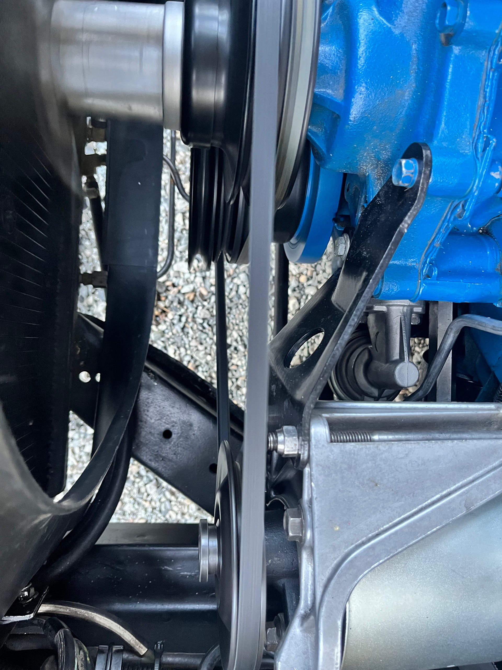

So, I bought a new fan, months ago. I ‘heard’ the original would be better than my flex blade that was on it when my dad bought it.
It sat on the wall for months, behaving its self.
I decided to put the fan and a newer spacer in it, a couple months back. I even bought a shroud because I never had one.
Everything was going good for a few days, then on our anniversary night the Cougar had other plans.
I jumped on the freeway doing 70 just to get to the next exit and something let loose, but the car didn’t skip a beat so I continued to the exit.
As soon as I got out I could tell the Incredible Hulk was bleeding green fluorescent blood.
Long story short….i got the fan too close!!! That’s gonna hurt my wallet and my feelings :sob:
Unfortunately, I have no idea why it decided to overheat now. It never did that before. It did run hot whenever the temps were above 85 or so. That’s why I thought something was wrong and went ahead and bought an original fan, spacer and aftermarket shroud.
That July 29th day I reported it overheated is because I put it through the test on a short 40 mile run up and down the pass at 70 plus. It was in the 80’s that day. I’m sorry but it was really breathing hard that day and if it can’t take that then something needs fixed. When I got home it was like it wanted to die.
