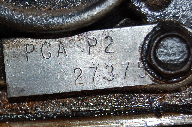

The casting date on the block is between the oil filter and the pan. The C6 should have a tag on the side attached by a bolt. The trans should also have a partial VIN but that is stamped on the top and tough to see without removing the tranny.

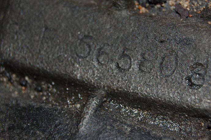

Here is a pic of how the VIN looks on the transmission.

I could be mistaken but 1968 Federal mandates brought Vin stampings to the engine blocks. Your best bet might be to look at date codes and compare those codes to the build date for your prospective Cougar GT. I think it’s more a probability than a certainty number matching pre 1968 Cougars. Someone else might be able to answer this more directly. Philip is spot on with his photos but they probably came from his 68 XR7G.
No vin numbers on 67 cars.
Vin numbers were on the cars but not required on major components until 1968. Certain Ford Hi-PO engines pre 1968 have been documented with vin or partial vin #'s.
Looks like I typed quicker than I thought. The vast majority did not have numbers stamped on the trans or block in 1967.
