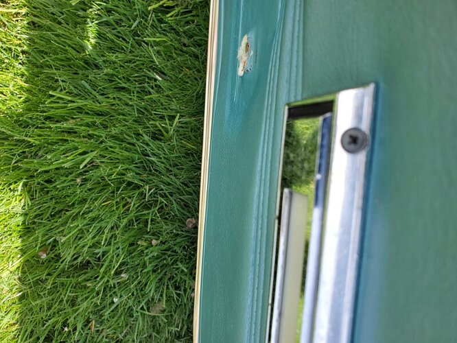

Hello! My 67 base model has the courtesy lights in the door panel. I assume these are XR7 panels. Curious if all Cougar wiring harnesses have the provision for the courtesy light? I mean if they all have the opera light harness seems likely?
Also, is there a trick to popping the plastic housing out of the panel? Or is it necessary to remove the panel? My courtesy lights are in reasonably good shape and I don’t want to damage them.
I have a 69 so it may be different. But there is a small Allen screw on the bottom side of the bezel so you can remove it and get access to the .mounting screws
The screw should be a phillips head. Removing those two screws will only allow you to change the bulbs. If you want to remove the entire courtesy light assembly from the door panel then you must at least pull the lower half of the panel away from the door. The housing part of the light has two studs on it that have self tapping nuts holding it to the panel. Plus you will need to unplug the wiring to remove the housing. Also on the 67-8 cars there is usually a small flat piece of metal that acts as a support that goes on the stud before the nut goes on. It is about 1/2" wide by about 2" long.

Mea Culpa, I was in my driver’s door today. Yes Phillips screws on the bottom of the bezel, speed nuts on the back. Gotta pop the bottom & back side of the door cards.
