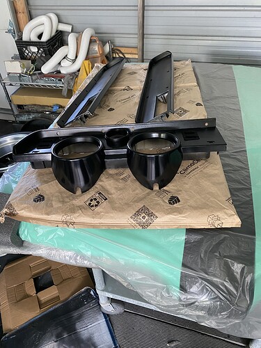

The first off-tool parts are on the way! These are not chrome and paint like they will be but they are ready for test fitting. pretty cool to see some of the detail in these.
A great deal of work remains but we are making progress.
This is the standard dash. It will accommodate both the '67 and '68 style face pads.

Pretty cool to see some of the back side detail. Notice that we are using actual metal theaded studs for mounting and not those impossible plastic tubes.

You will reuse the metal attaching hardware but instead of those crappy melted posts there are screw bosses and we will supply the screws. It won’t matter to you but there are multiple different brackets and we accommodate all of them. All that you will see is that the hardware you have will work.
