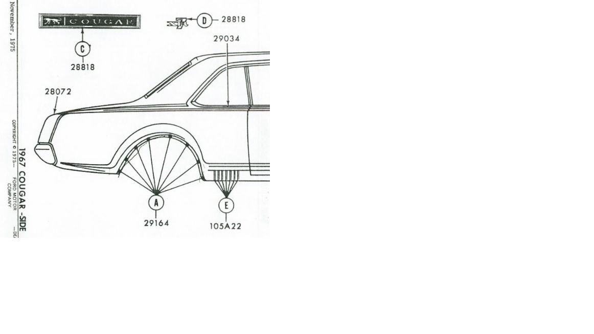

What retainers hold the “cougar” name plate on the quarter panels? Thanks

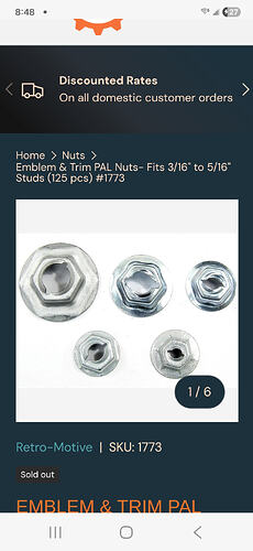

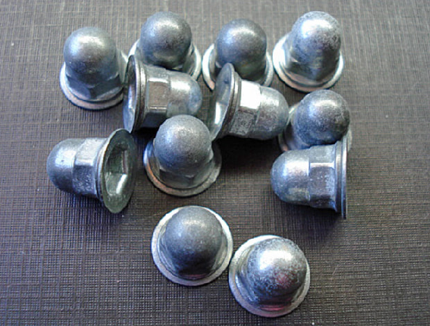

Not exactly. But close
Thanks. I have some of those. I just wasn’t sure and honestly if it matters really which ones as long as they grab the studs
The nuts that mopauly 1965 posted are not what is used. So, what confuses you about a barrel nut? You know what a barrel looks like? Now just imagine that barrel without a top or bottom and a slit up the side. The barrel nut pushes into the hole in the sheetmetal and then the studs of the emblem slide into the barrel. No wrench or socket will fit on a barrel nut as they are perfectly round.

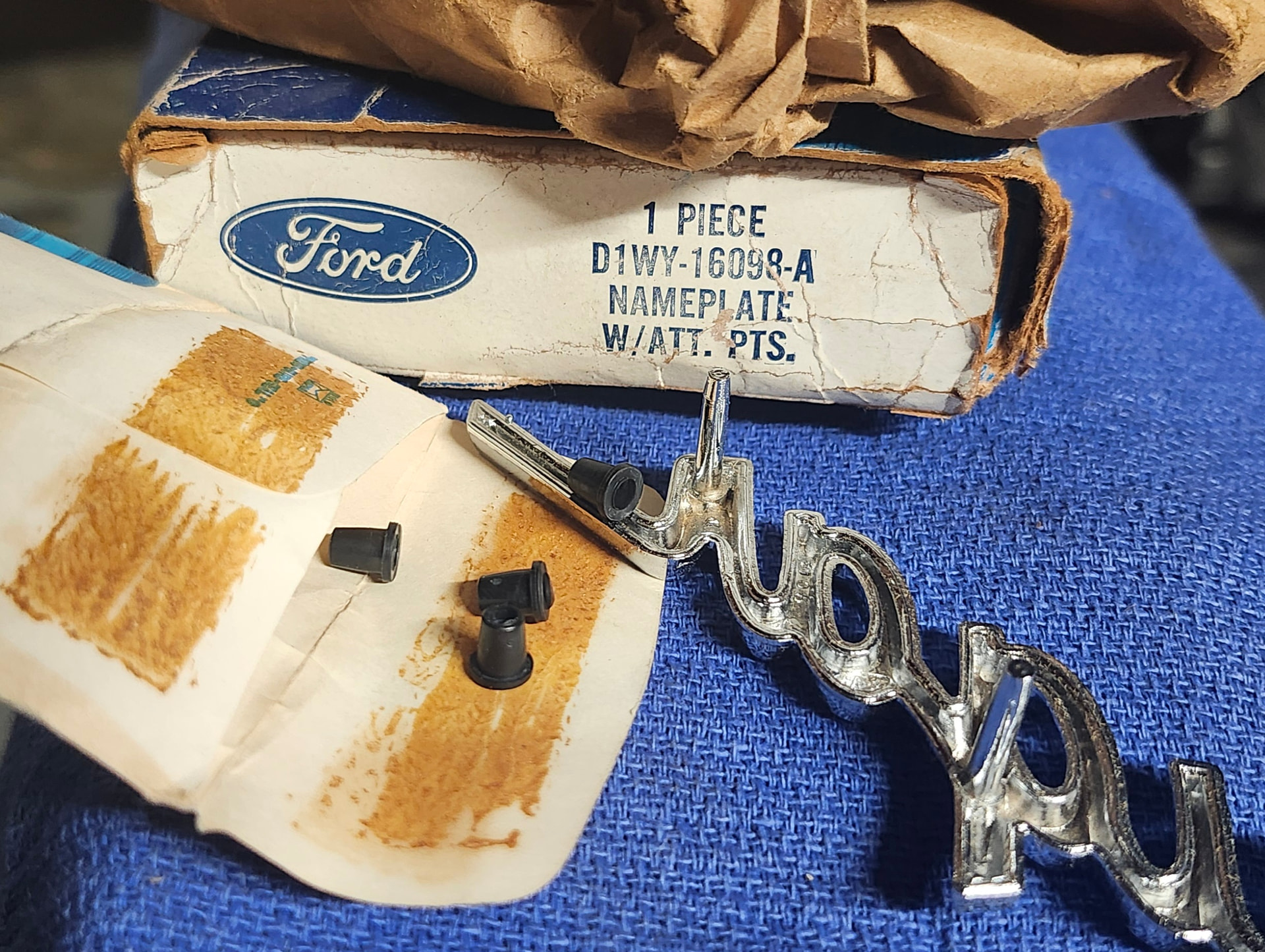

1967 only quarter panel COUGAR script with steel retainer.
Later non-corrosive type.
W/PLASTIC ATT. PTS.

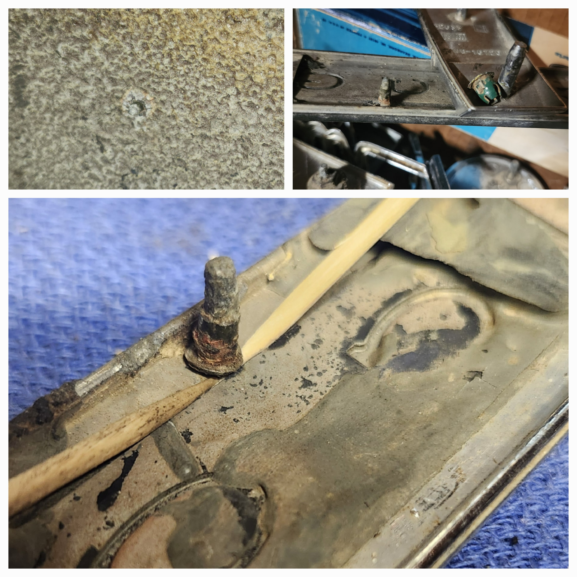

I saw the listing on wccc but wasn’t clear which ones were used for that particular part. They appear to be slight different ones in the pics.
The design for barrel nuts has changed over the past 50-60 years. Plus there are multiple different manufacturers that each have their own design. The design is not the important part, what is important is that you get the correct size to fit both the hole in the sheetmetal and the diameter of the emblem stud.

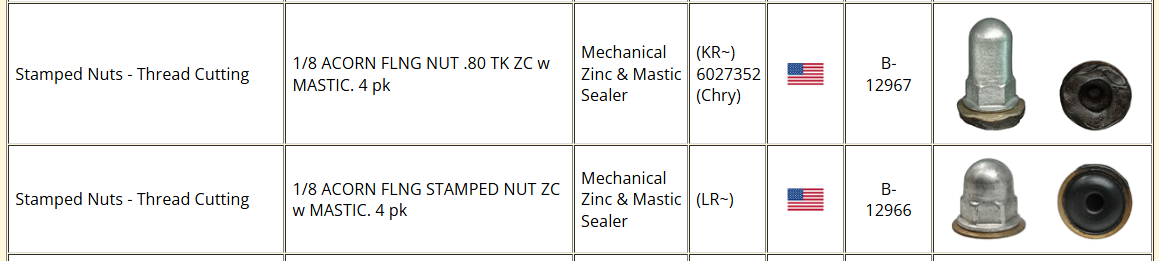

This is what they look like ( ‘self cutting’ barrel nut / acorn style with mastic ) :

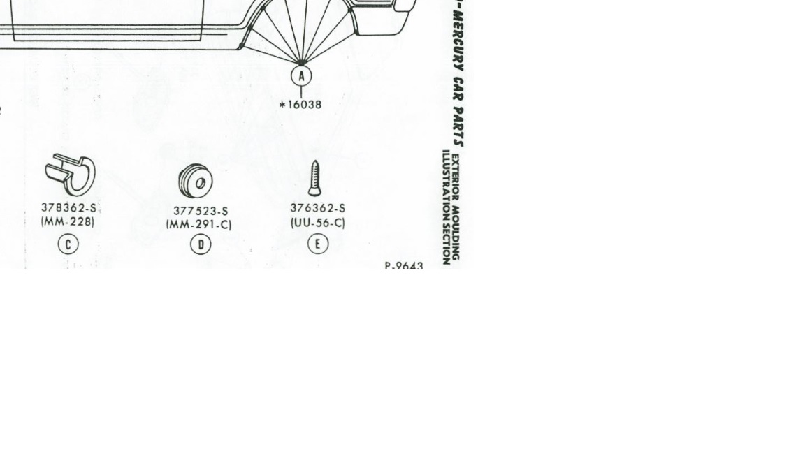

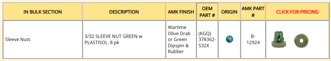

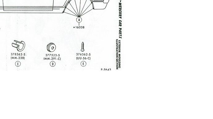

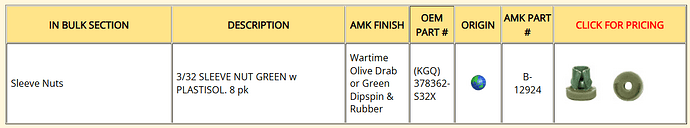

My error ! I assumed that the 1967 would use the same barrel nut ( acorn style ) that my 1969 has. NOPE. The style was the sleeve ( style ) nut Ford hardware number : 378362-S
Thank you. That’s a big help!. It’s crazy that Ford used so many different retaining hardware.
