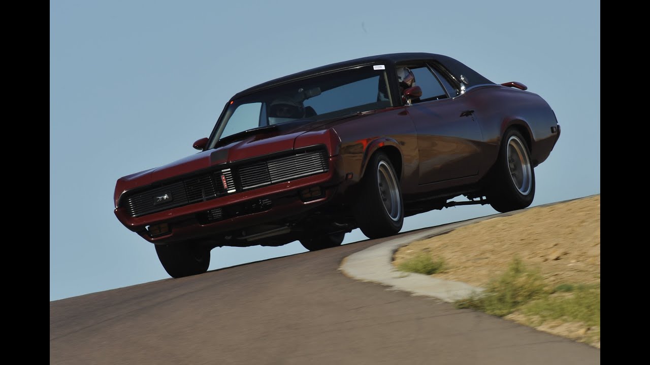

Like the video, Cougar_Bill. Do you have the details on your car somewhere?
No, sorry. My reply was to Cougar_Bill about the video. I would also like to learn more about that car! Good luck on the springs though.
DOH - the question was from Trixie - not you Calicat!! Edited accordingly. Sorry about that!
The Cat is a 69 XR-7, originally a H code Windsor. It has a very strong full roller motor with alum heads,approx 550+ A worldclass T5 rebuilt with racing components.
Suspension is factory w/ Moog parts. Shelby drop & upper A arm modifications as per the Boss 302 chassis mod book, export & reinforced cross member. 8356 coils springs with 1 full coil cut. 1" block in rear leaf springs (66-311). Brakes are factory with Porterfield carbon brakes. Tires are Hoosier TD track tires on 15" wheels.
