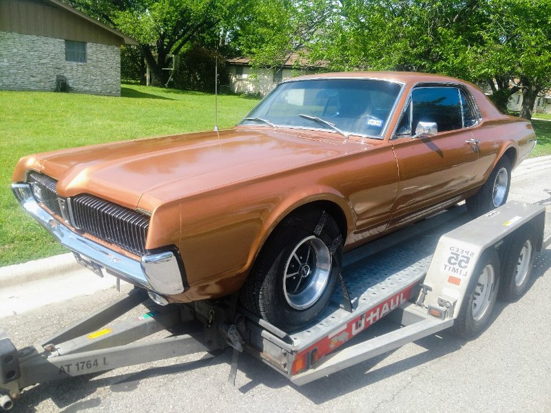

. Here she is when I brought her home last weekend.
Welcome! Your car used to belong to the Sheriff of my town. I bought his house and his car! Call me sometime to hear the rest of the story… Here is where you will get the best turn signal help.

I don’t think it’s the same cat Don.
When I sold it to Peter (after buying it from you) it had the wheel opening mouldings and hood trim and new emblems.
The wheels look very similar though.
This one came from Houston via El Paso. Has a 351W with AOD if that helps you in determining that.
Yup, not the same cat. Looks good though.
