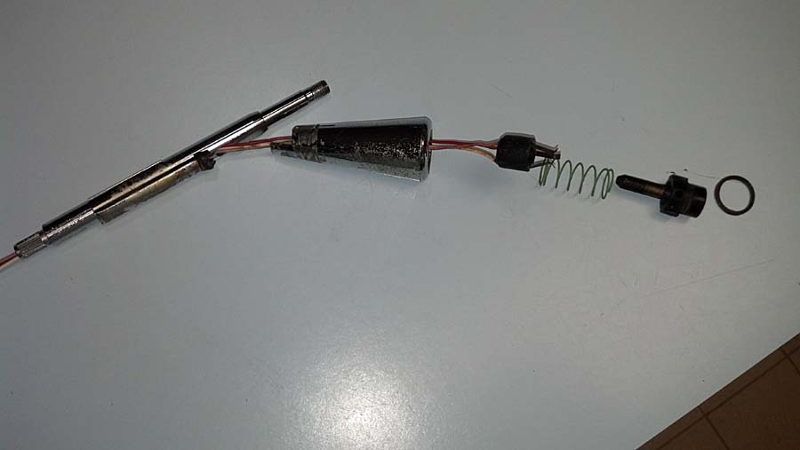

I was wonder if you guys can point me in the right direction. I have the 67 turn signal lever for cruise control as pictured on WCCC website below. The button on mine just wants to fall out and doesn’t appear to be spring loaded like I would assume it to be. Obviously it must be missing a spring and some kind of stopper to prevent it from popping out the end. Do any of you know where I can find a picture of this part disassembled to see what I’m missing? Or do you know what and where I can find the pieces I need to make it function correctly?

Does this help?
Yep that would be it, thanks! I’m missing the spring and retainer ring. Spring is easy, retainer ring I’ll make something.
