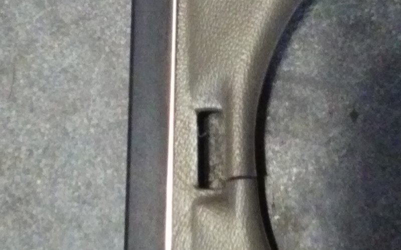

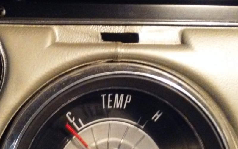

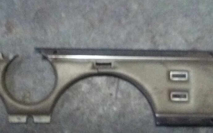

So here are some pics. Sorry the one isn’t better. So first 2 pics are of my non a/c dash pad from parts car. This parts car was a late production year model. The pad has the bezels around the windows. Note the small flat spot where the high beam indicator window goes. I took the window and bezel out, that’s why it’s not there. The third picture is of my a/c pad in my car. I didn’t take a picture of the other windows, but they don’t have bezels around them, they are just the plastic windows attached to the back of pad, but note how broad the flat spot is around the high beam window almost like a 68 style pad. I considered the possibility is this a 68 pad, but didn’t 68 pads also have a bezel around the wiper switch opening? Where as this pad has just the rubber flashing or what ever you want to call it glued to the back side. I also thought 68 pads had a stitched accent area around the “Cougar” inlay on the pass side. This pad in question is smooth all in that area and just says “Cougar”
So I did some research today, and found that at least the early production 67 Cougars without the bezels around the dash pad openings, did indeed have a wide flat spot by the high beam indicator. http://wwwcdn.oldcarsweekly.com/wp-content/uploads/1967-Cougar-8.jpg shows a link of an early Cougar (no back seat arm rests) that has no bezels and a wide flat spot.
Question answered. Now to bezel, or not to bezel :slight_smile: Hopefully when I pull my pad off I can find my little blue window that fell off.
