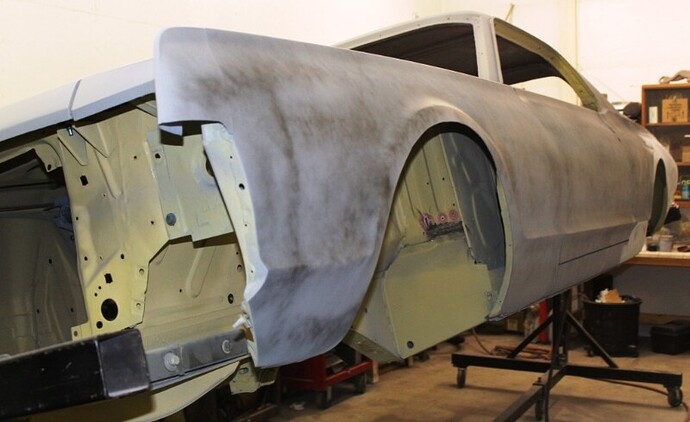

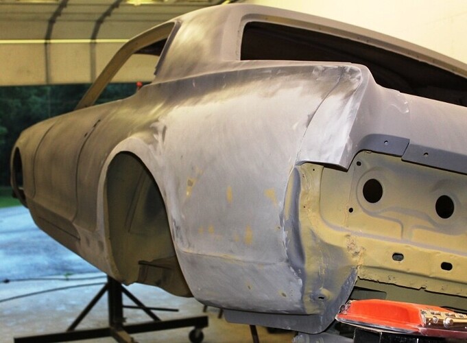

No aftermarket flares available that I know of. If you find some let me know. I flared the arches by cutting down the lip on the inside. Then sliced the arch in pie shape cuts and bent them out. Then welded the cuts together. Most of them turned out good except for the p-side rear is choppy.
Brian I never noticed your fender flare modification. Well done in a way not to take away from the Cougar lines.
