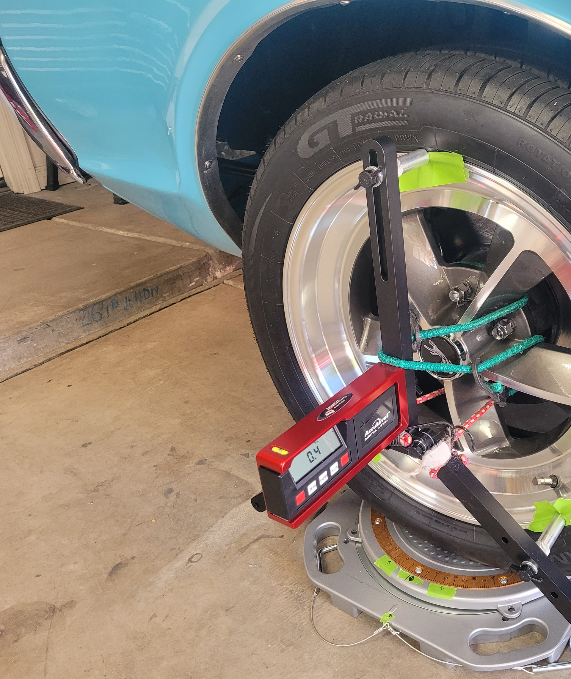

Decided to take on a DIY alignment using a digital Caster/Camber kit after I couldn’t find a shop despite the simplistic design (a lot of no we don’t do those responses…).
Car has all new stock replacement steering/suspension parts and has a staggered tire/wheel setup (front = 215/50ZR17 on 7 inch wheel; rear = 245/45ZR17 on 8 inch wheel).

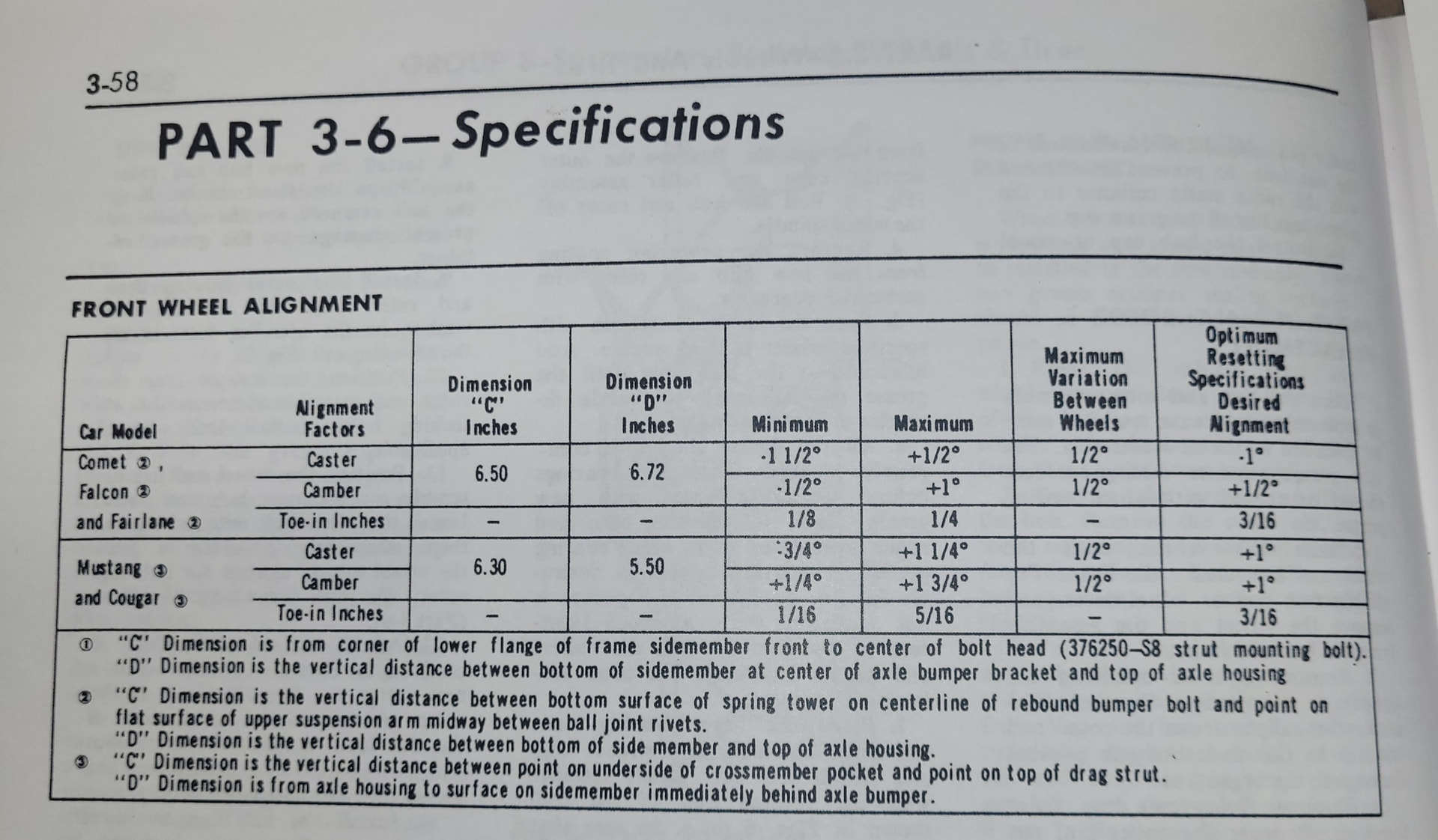

I’ve set drivers side per what the shop manual describes as “optimum resetting specifications” (both +1 degree) but now am questioning the camber due to potential tire wear on outside edge.

The factory specs are for bias-ply tires; modern radial tires take a much different alignment. You can find a good alignment for our classic cars on various forums.

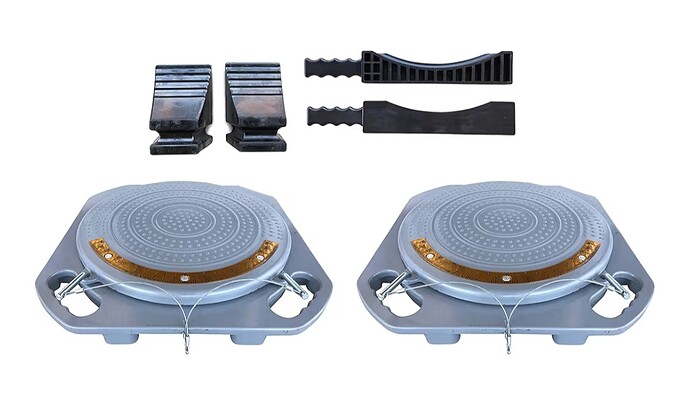

DIY alignment - like so many other areas of these old cars - isn’t hard so long as you have interest in learning new things and buy the right tools. I ended up settling on a digital clinometer kit with mounting apparatus and a pair of turn plates. Instrument was a little more money than the bubble type but well worth the improved accuracy and repeatability. Also, equipment is very easy to use once you get familiar.
I have the same Longacre setup. I like it, just have to be careful of making sure the adaptor stays on the wheel. Just dont have the turn plates, which ones do you have?
Nothing terribly fancy but do work very well. I’ll send you PM with link.
A very cheap version of turn plates is to use plastic trash bags (3 mil at least!) folded in half.
This is what I’ve done in the past but turn plates would so much nicer to have!
