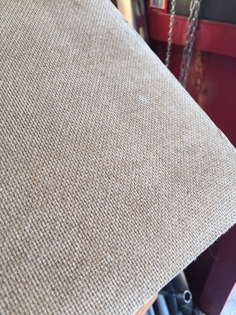

Anyone know what the finish should be? Do I just pain this really rough surface?

However, I have seen other cougars that do not have vinyl, rather the package shelf is painted with the rough side up (as shown in the picture you posted).
Coach Jack
The answer is yes, paint to match interior.
I am working on a 68 Mustang , and this has rough side down not painted, smooth side up painted
I have two Cougars with rough side up painted!!
No vinyl covering originally, just the naked fiber board like you have pictured. Mine was black, and I’m unsure if they were all black, or if they color matched them to the interior.
Thanks folks for the answer to such a minor question. just seemed odd of the finish. the other side (smooth) has something engraved in it and figured it cant be the top side. I bet there was even confusion on the line back in 67. lol . THANK YOU AGAIN.
For the '67 and '68 cars, the rough (cross-hatched) side goes up and they were color coordinated with all interiors, except white. On cars with white/parchment interiors, the package tray was the color of the “appointments”, i.e., dash pad, carpet and rear package tray/lower back window molding. On my '67 standard with trim code UA (parchment with black appointments), it was black, of course. If your interior trim code was, say, UD (parchment with red appointments), the dash/carpet/package tray would red.

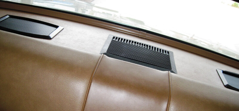

I made this one then painted it with paint that I had matched by one of those “custom paint” matching places. It isn’t perfect but I like it…
I used.a saddle speaker cover material from amazon and glued it down. Looks great
Mid 60 vw bug seat vynil had the same weave/ texture as the pressboard did and with an 1/8 foam adds some sound deadening. Kinda matches the weave in the std seat back trim
