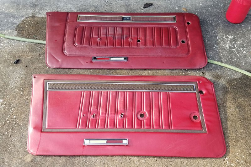

Was the decorative weave on the red interior originally a maroon color? It seems really brown on my 67 (bottom panel in photo).
I was planning to switch over to a set of 68 panels (at top in photo), which are in better overall condition, but the arm rest holes don’t line up. Can anyone verify for me that the lower panel is indeed a 68 panel, and if so, did the 68 have a different armrest?
The rear hole is in the same position, but I’m going to have to cut a new hole for the forward arm rest bolt if I put these on the car.
The top right screw hole is also in a different spot, which means drilling a new hole in the 67 door.
Just wanted to verify that these were indeed 68 panels and that they would work before I start modifying things.
The upper panel is a 68 decor panel and the lower panel is a 67 standard panel. You can tell quickly by the length of the basket weave piece. The 67 panel has the longer piece of basket weave. The 68 decor panel uses the same armrest as a 68 standard panel. The 67 standard armrest is different than the 68 armrest. Yes, the basket weave piece should be red, not brown.
Thank you, Randy.
You’re welcome.
