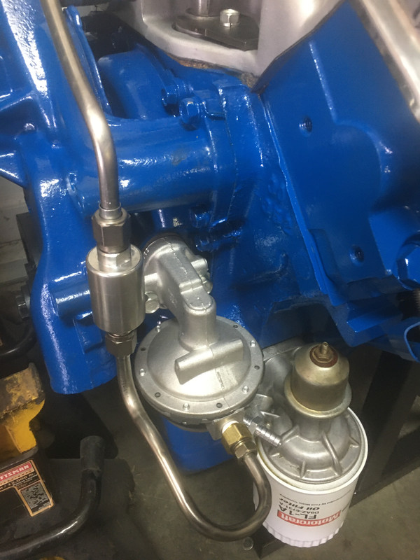

I have done a few hidden Cobra Jet strokers, where we restore it to look concours-ish, but make 550+ hp. I have been doing two things for the fuel system
1 - I convert the fuel bowls to dual inlet, if required and run this larger crossover tube. (on a 390 the stock crossover tube is fine, but it’s so small it can’t keep up with a 461 and 560 HP or so
https://www.ebay.com/itm/HOLLEY-FORD-HI-FLOW-CHEATER-5-16-FUEL-BOWL-CROSSOVER-TUBE-302-428-429-/232889200014
2 - The filter side can be tough because nobody makes an affordable or replaceable Boss 9 filter (3/8 inlet disposable), so we did this on the last one, it is an Edelbrock filter, with the name turned back behind. Keep in mind, Classic Tubes can make anything you want.
This was actually an original Ford “dollar car” racer, 68.5 CJ coupe, we built the engine with an alum intake as the owner wanted to build it as a racer which would have had some modifications each year, but you get the idea
3 - I don’t think there is a pump with a 3/8 outlet that looks stock, if anyone knows of one, let me know, it would be a handy thing to have in my back pocket

Thanks…that’s exactly what I’m trying to do :-). I was thinking of using that stock looking crossover tube…Royce mentioned it as well. Will check that fuel filter…easy solution turning it around. I was thing of purchasing a tube bender and flaring tools…don’t mind trying it myself…will keep classic tubes in mind though.
How did you modify the carb to accept fuel on the other side of the bowl though? The driver side ports aren’t threaded…or don’t appear to be.
