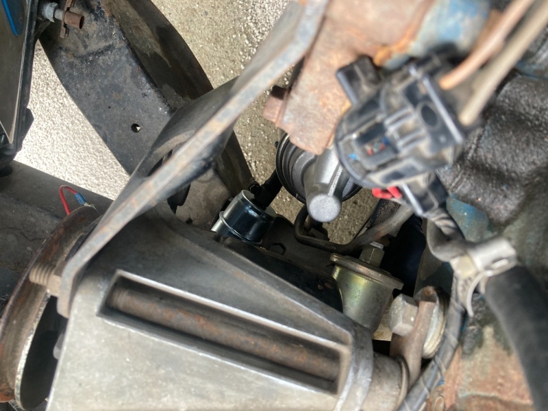

The hard line I ordered did not fit, and the bender was useless. I will make my own line and get a better bender. In the meantime, I moved the fuel filter down to before the pump and plugged the hose right into the carb.

Mechanical fuel pumps are good at pumping fuel. They are not good at sucking fuel. That’s why fuel filters need to always (always) go between the pump and the carburetor.

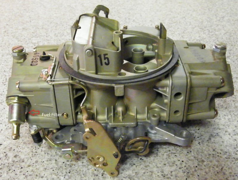

What does a factory(ish) set up look like?
Agree with Royce. Also a safety issue with those clear plastic or glass fuel filters, especially when installed where not visible.
I would go back to factory fuel setup which had the pre-formed steel fuel line running directly from fuel pump output to a short piece of clamped rubber hose that connected the steel fuel line to a metal can fuel filter that screws directly into the carb.

Like this. Ford typically screws the fuel filter into the carburetor. Fuel filters are always metal for safety.

I did bend up a hard line from the fuel pump to the carb after my last post. The filter I got did not fit the threads of the carb inlet, so I still have the metal fuel filter placed before the pump. It’s been running fine that way.
