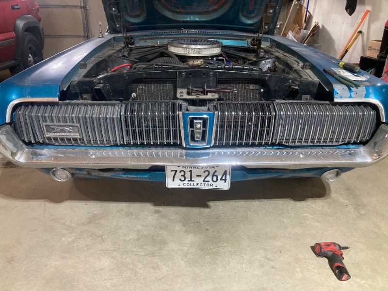

I tore into it on Monday, but I got frustrated and had to walk away. I could not reach the high pressure line on the control valve. I’ll try again this weekend, maybe.

I got the power steering fixed up today. I used the WCCC corrected concourse kit, and now the hoses are routed under the engine. There’s no leaks, except for the heater core that decided to start dripping today. That’s pretty cool.

I did find that the old high pressure hose was cracked on the hard portion right where it bends to join the control valve. They were the factory routed style, and there was a chunk worn out of the old line. Surprisingly, the hose wasn’t burnt at all.
Now, the steering is so light that I can turn the wheel lock to lock with one finger. I took a short cruise to town, and the drivability has improved immensely.

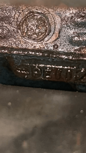

I checked out the engine casting number. It’s a D9AE-ED block. The lower number tag looked like 9E11, but I haven’t found anything on that yet.
D9AE-ED is the part number for a 1979-82 351W with 2 bolt mains. 9E11 would be the casting date which in your case decodes to May 11, 1979.
Thank you. I couldn’t find a date code guide.
