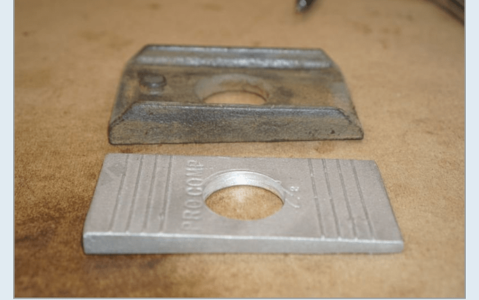

Conventional lowering blocks will not work with the factory cougar setup with the rubber isolators and factory pinion degree wedge. Some guys like to convert over to a mustang style but you need to account for the pinion degree wedge some how when doing this. Instead I made my own blocks to fit. Take a look on how I made my own blocks to accommodate

My purpose was to adjust the pinion angle but the shim will lower the vehicle as a side effect. These 1/4” 2 degree shims (Summit) had a small hole that I needed to bore out to the size shown. They could be straight blocks depending on what you find. I also needed to use longer U-Bolts.

keep us posted on how it works out for you. You can also play around a little bit with height too, I made another 1.5 and 2" block to try as well to see where I wanted it to end up. Im comfortable with running a 1" block long term but anything bigger I would go with a spring instead for a permanent install.
