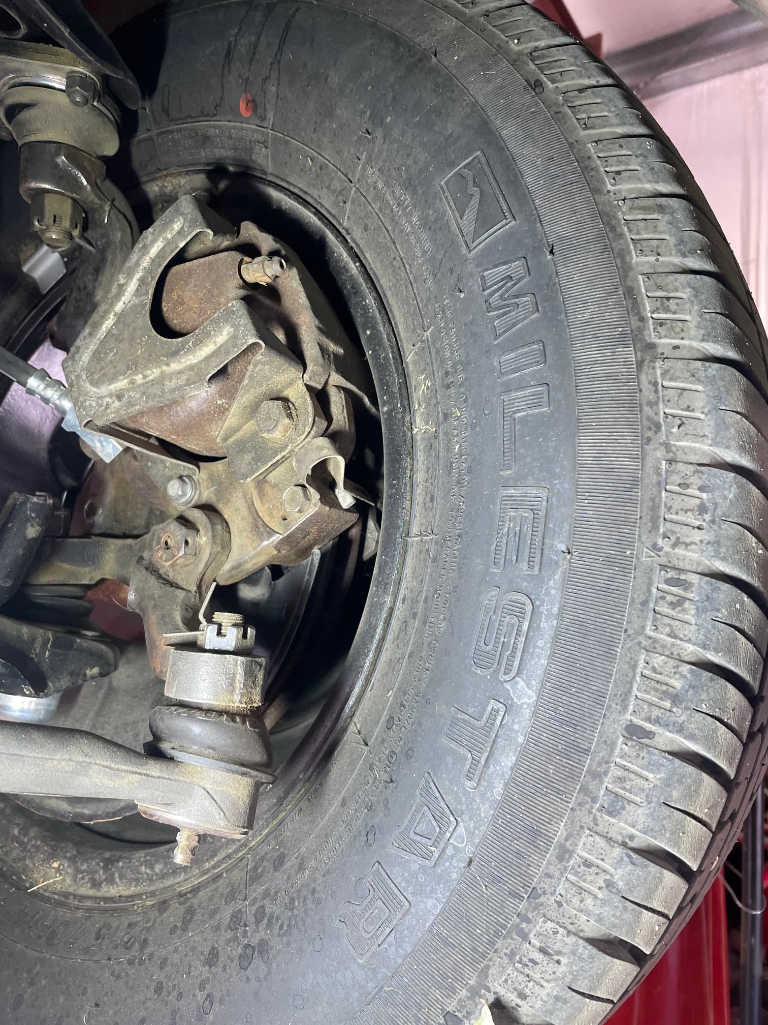

Take a photo of your front disc calipers.
Here is a pic of my passenger side caliper, drivers side looks the same.

Looks right. Still might be bleeding technique.
