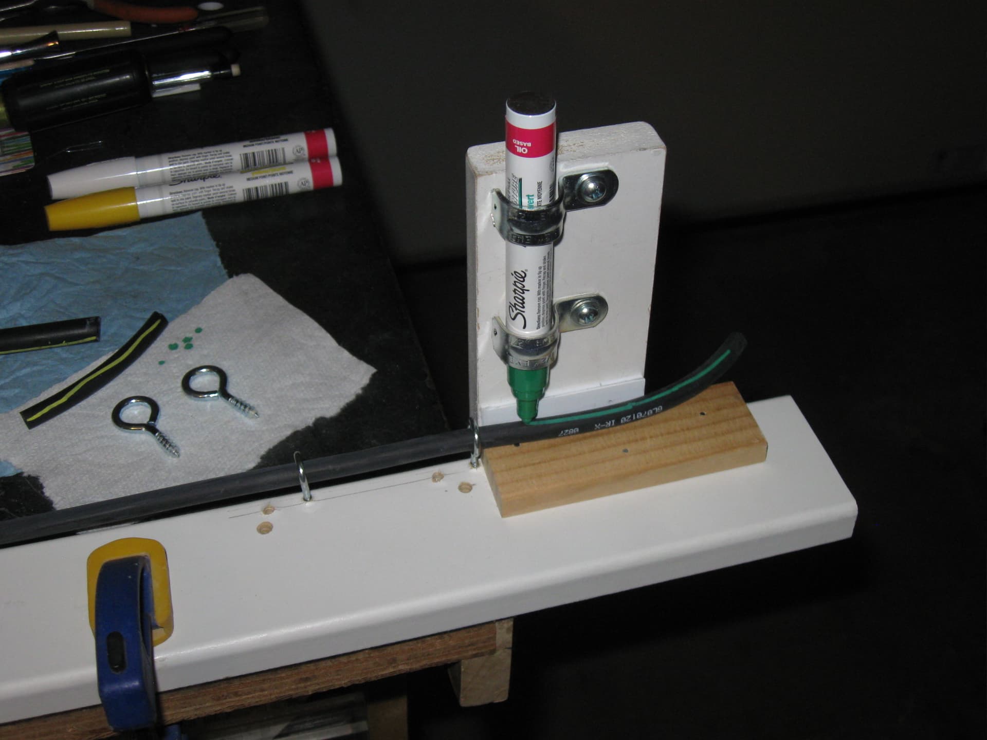

I made my own for my 67. Purchased a couple spools of vacuum hose from Rock Auto (7/64” and 5/32”). Then made a jig to paint the white/green/yellow stripe on them.
The eye screws are just big enough that the hose can be smoothly pulled through it; I used different size eye screws for the different size hoses. The paint pen is from the hobby store. Pull the hose slowly so the pen has enough time to paint to get a bold line. I don’t have a finished pic, but they came out pretty good.
That is fantastic! all we need now is the length of each hose and the sizes.
Nice fixture. Thanks for sharing
