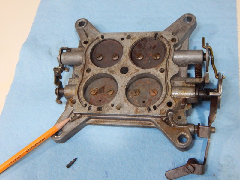

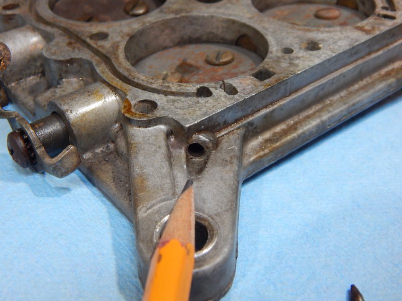

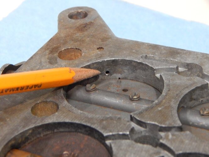

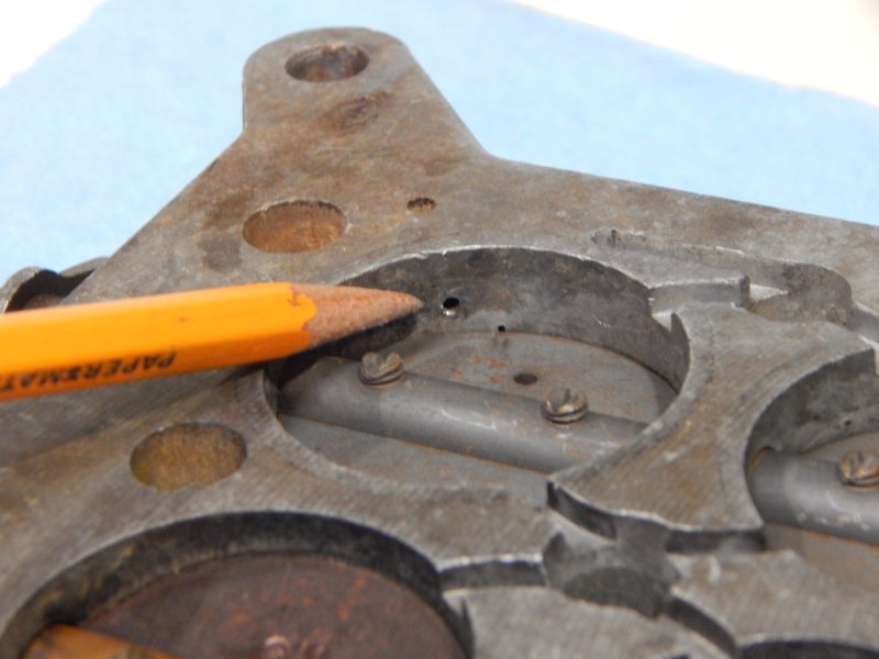

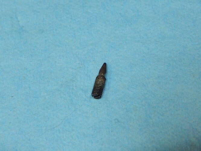

Soooo, now that we have digest the above, here is another anomaly that may exist in any Holley carb in the 1967 (late) 1968 era. I have seen this mostly on 3795 and 3796 Holley carbs on 390 Mustangs and Cougars. I have also seen it on a couple 4174 and 4168 carbs for 428 Cobra Jet engines. The 4088 is cast with the same area for these extra needle valves in the throttle plate. This hole was not drilled on the throttle plate in the 4088, but has been on about 5 carbs I have rebuilt. This hole contained a small needle jet that I will try to send another picture of. My guess is Ford requested Holley to assist with emission control and this was a second idle mixture screw to lean out the idle. After installed a thick paste was put over the jet hole to prevent air leakage.
The Holley carbs that I have seen on the 390 and 428 were so lean at idle that they performed very poorly. I have removed the paste and screwed that idle jet out enough to take it out of play. Reinstalled with some lock tight. They are very fragile and I have had to use heat and persuasion to get them out the first time. Once out of play the idle mixture screws in the metering block react more and I can smooth out idle and improve the transition away from a stop sign.

Another pic or two.
I also should have said that I would not be surprised to see the throttle plate mixture screws on a 4088 carb. If so they would affect the idle a whole bunch. I am beginning to feel that Royce and Bart are the only ones with a GTE that runs!!

Were the castings similar, but the hole not drilled of course. Bart’s 4088 had an identical casting to the ones I have seen drilled, but again his was not drilled. After a bit (a year or so) this casting configuration disappeared in my experience.
