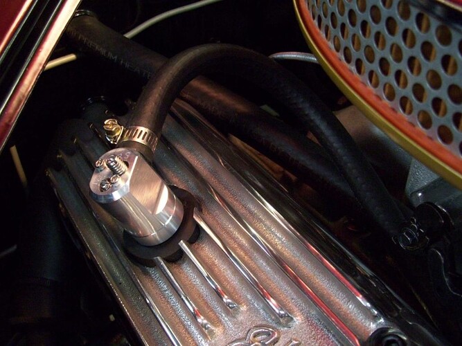

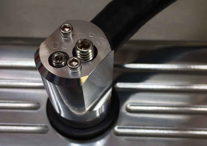

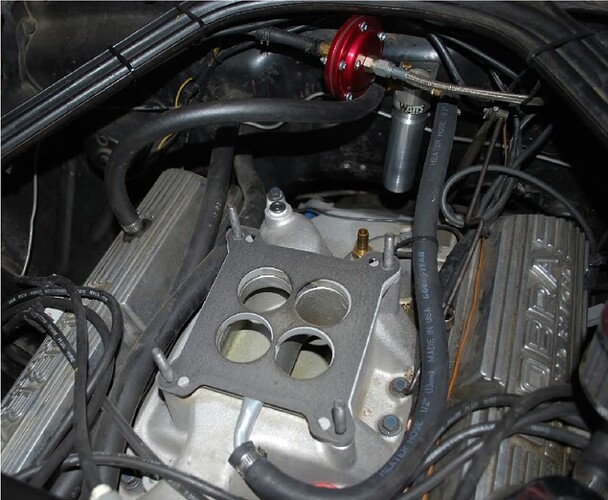

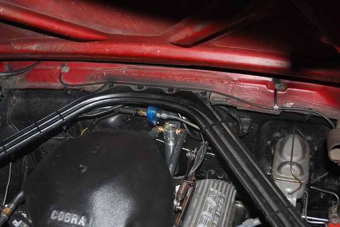

In the meantime there are a couple of bandaids you can try. I’ve used both of these products, and they work beautifully, and for what they cost, they should be flawless :wink: :
oil catch can; it will trap the excess oil before it gets to the intake, of course you will still be using too much oil, unless you recycle the catch can oil. Don’t know if I’d do that, too many blow by acids in the oil vapor being collected…

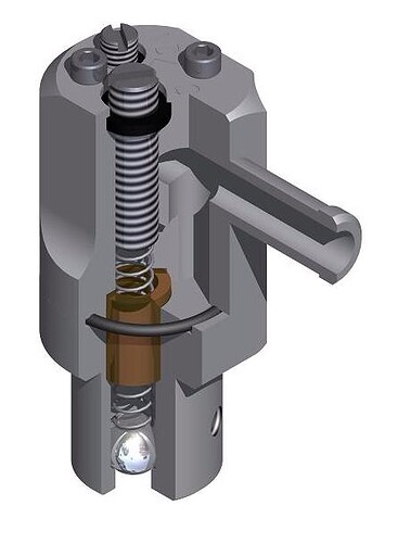

a custom PCV valve might benefit you as well. Now THAT might help your oil consumption:
