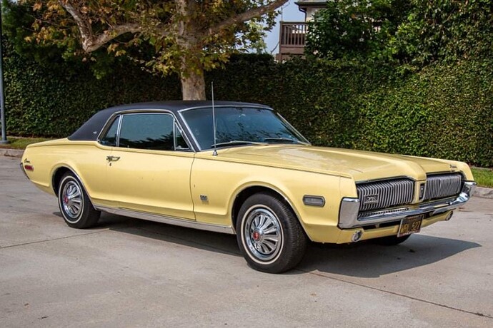

68 leaf spring suggestion - get rid of saggy butt
I havnt contacted WCCC yet, but checking on recommendations on rear leaf springs to at least level, if not a very slight forward rake (rear higher) for my 68 with 390, before I upgrade the wheels to a Shelby style (17-7/8) this spring.
Will this change in leaf springs also trigger a coil spring change in the front?
I should have taken a good pic and measurements before putting the car in storage, but here is a past pic.

I thought I read somewhere where Cougars have always had a slight reverse rake…i.e. rear was slightly lower from factory. I didn’t want to go though the process in buying/installing new leafs to go from sagging to less sagging :slight_smile:
