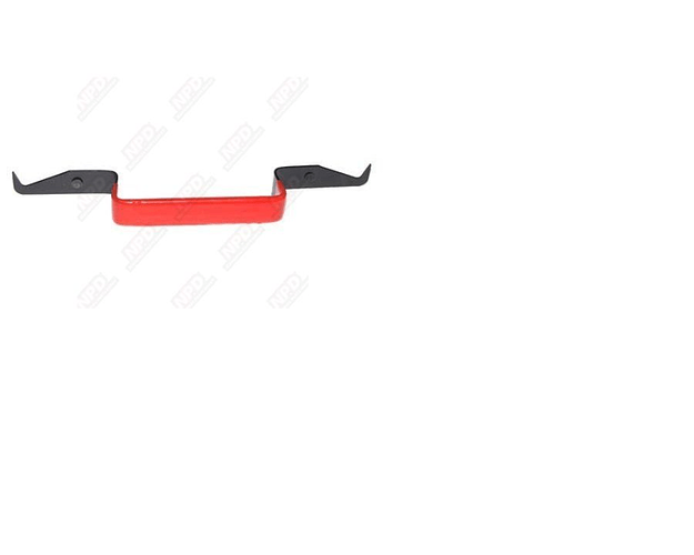

Looking for tips on removing the back glass trim. I was able to remove the front trim with no problem, but the back glass is a different story. Are there any video’s out there? The trim is so tight to the seal that I can hardly get the trim removal tool inserted to even find a clip. I have attached a pic of the tool that I am using. Is there a different tool?
Any direction is appreciated…

That is the right tool, its all about feel and as you know takes some experience. Go slow and take your time and they will come off.
yep mine was a pita too since it had never been removed and the rubber was hard as a rock. just find a spot that will let you get under it and work slowly from there
