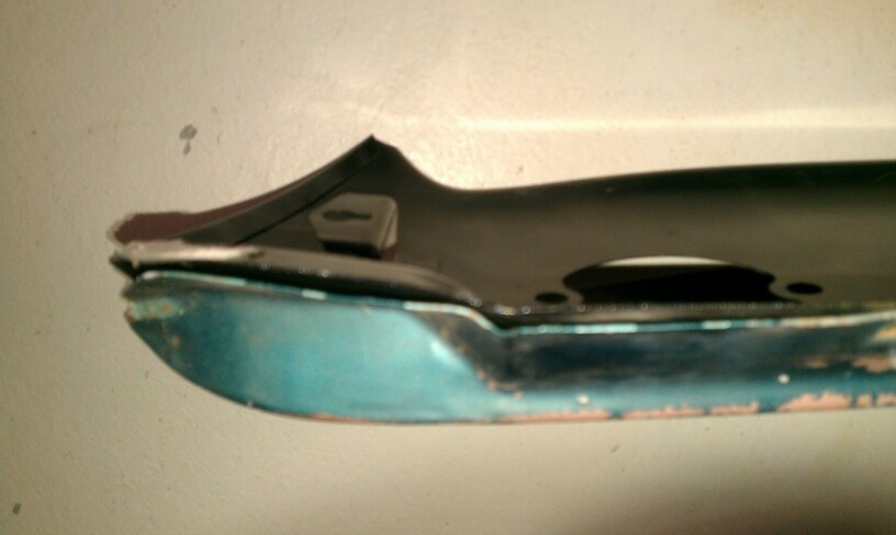

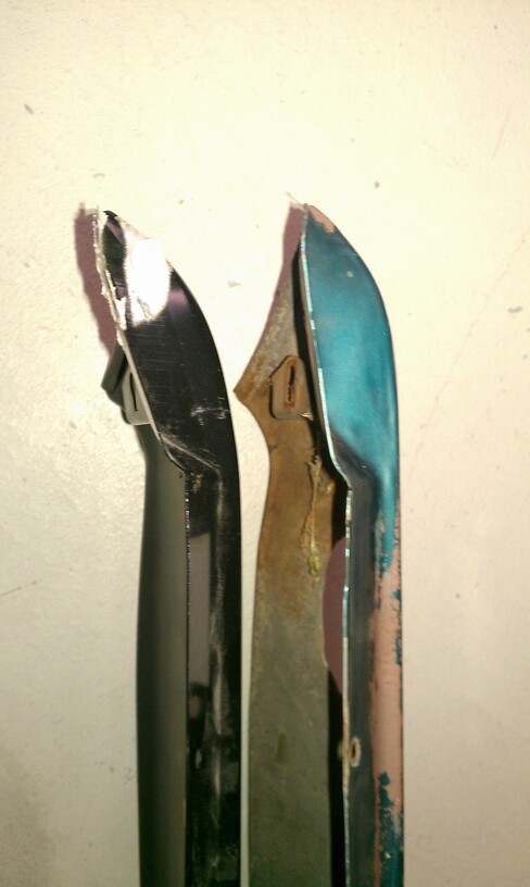

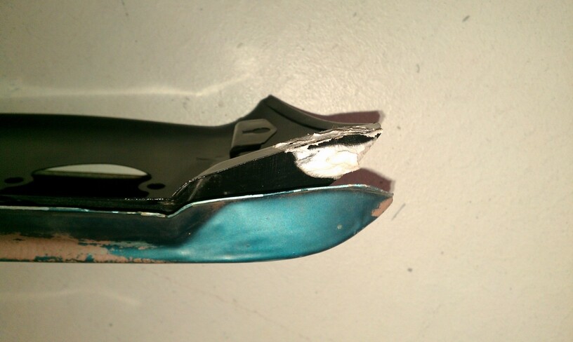

What’s even more mind boggling is I got the replacement one today, three years later and they still have not corrected the problem. Don, I am not sure if this is the same one you sell, but (I think) it does have the same part #. Is this the poor fit you were talking about? Check out the pictures and you will see where the problem is on the passenger’s side when compared to the original from my car…Does anyone have any words of wisdom on how to get this thing bent to shape without cutting, welding, and cussing too much?

I cut a slice in the top side of the valance and bent the outer end out. Also had to do some bending on the lower outer edges on both ends to make the space nice and even where they meet the quarter panels. Now I just have to get the slice welded back together, add a little plastic in a few places, and it will be all good…All that makes me wonder if I should have just tried straightening my original, which is virtually rust free, but has a crease in left center and is a little less than straight all over…we’ll see.
