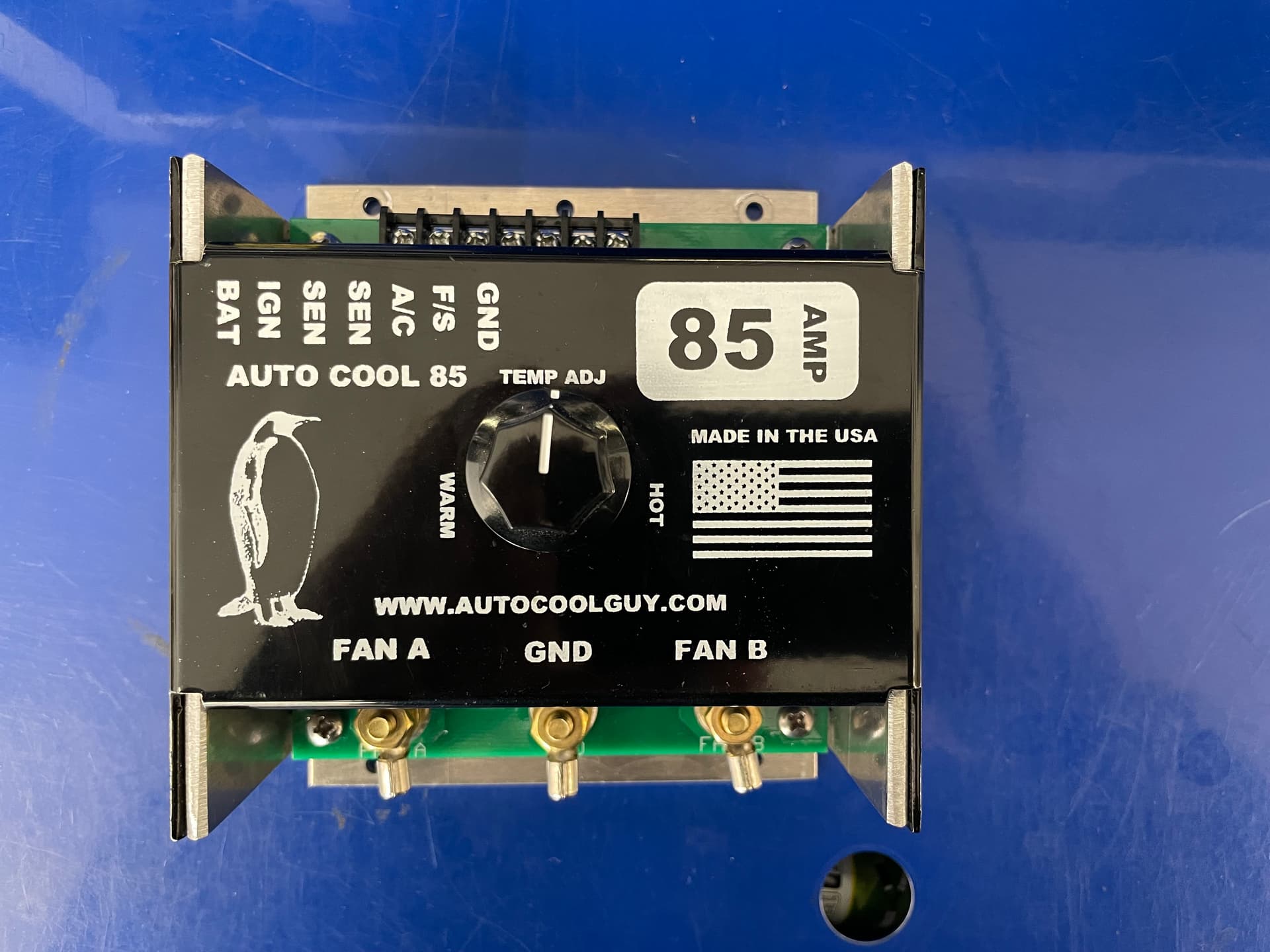

68 standard, just a classy driver!

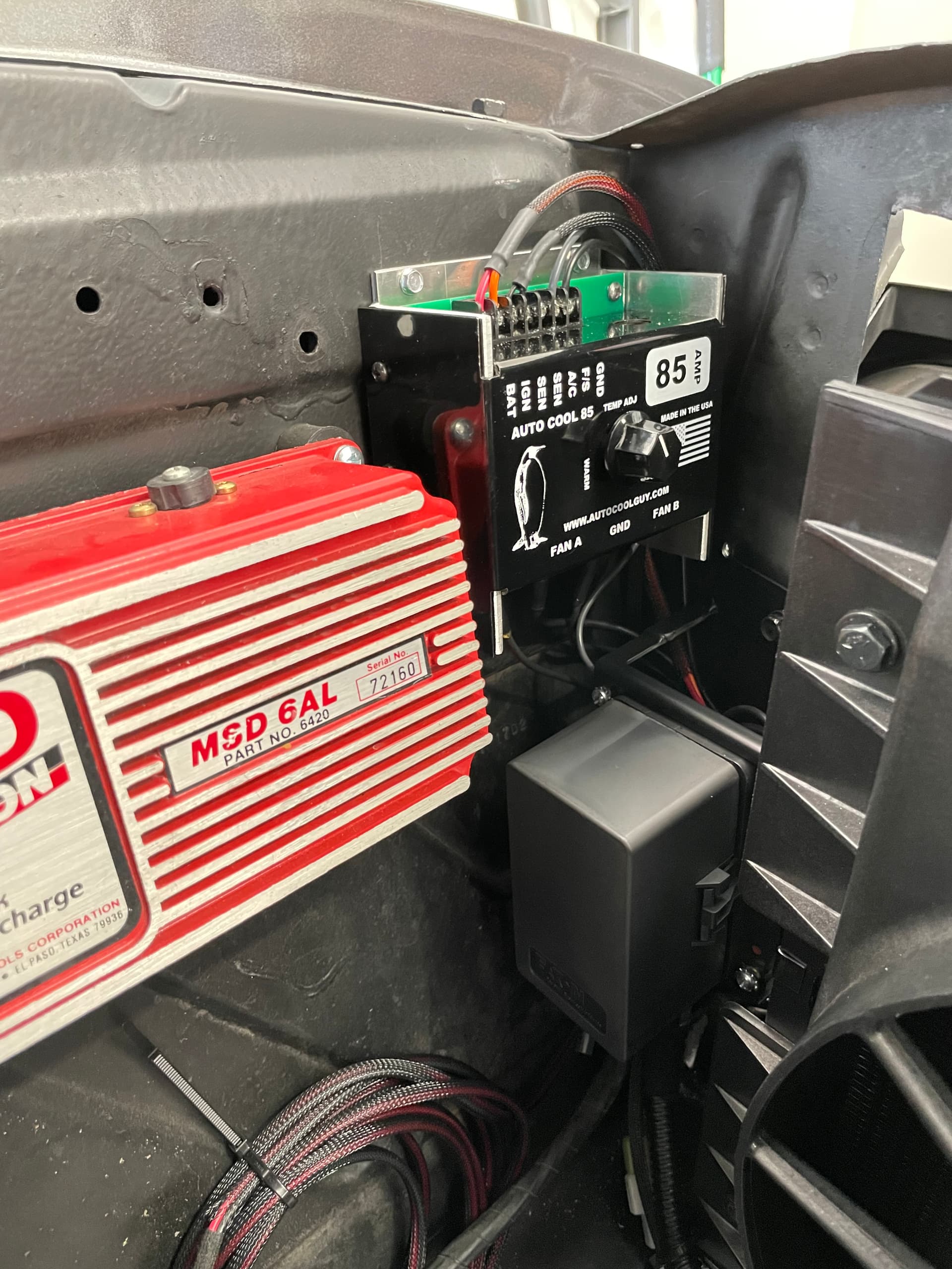

That’s interesting that you actually needed to ground the compressor case, you’d think it would have no problem connecting to ground through the mounting brackets. Which PWM fan controller are you using? I’m considering going this route as my fans are insanely loud at 100% on.
I was caught off guard with that one too, didn’t think it would need it but apparently my paint job on the bracket was too good to get a good ground. Easy fix none the less
My pwm is from auto cool guy. The website is terrible but it’s easy enough to reach out directly for questions. Very helpful if needed. I’ve been very happy with it and even installed one in my dad’s Mustang. I have the 85amp version on both cars. Wiring is simple and it’s weather resistant enough to be under the hood. It will control the fans from 0-100% as needed and you can limit max fan duty cycle with the knob. As the engine warms up they will increase as needed to control desired temp. Override circuit to run a remote switch to go straight to 100% if needed. Ac control with independent speed setting triggered by 12v so will cycle fans to set speed when compressor cycles even on a cold engine. Fans will run for 1min once car is shut off as a cool down function. I have mine limited to around 60-70% and controls temps just fine on the hottest days. I will probably need to adjust ac fan speed higher to compensate but will see.
I think any pwm fan controller is a must with electric fans. Relays work but it’s either on or off with no in between. If I remember I have the same fans you do and when they are running at full tilt it’s quite loud!
This was the best option I found at the time but there may be better options out there today.

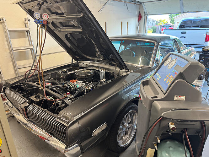

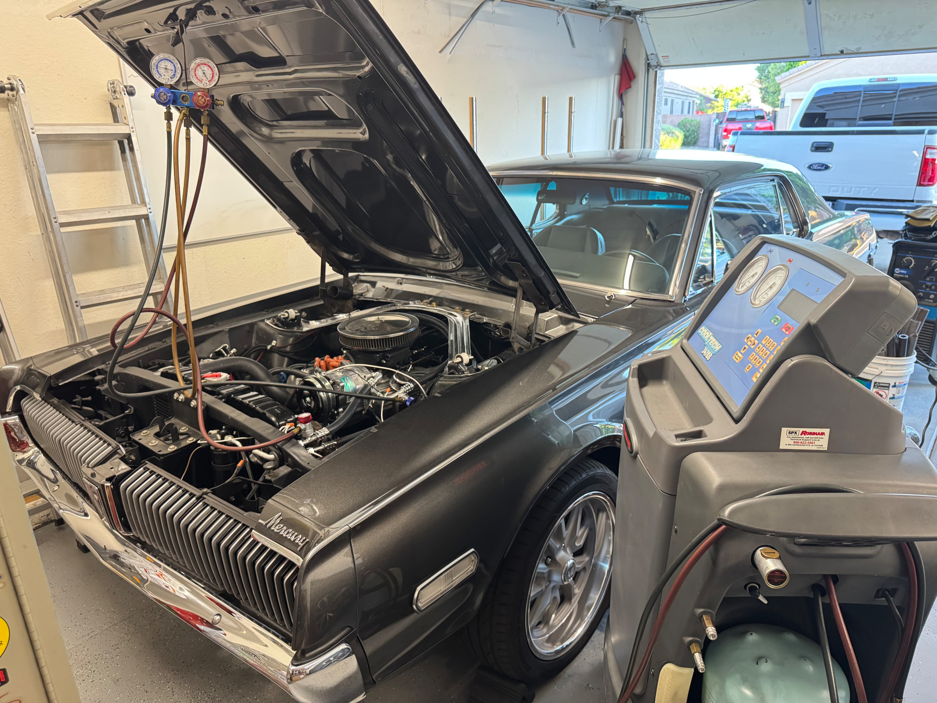

In the last post I mention not being happy with the charge level based on the pressures I was seeing. I was having trouble with my vacuum pump leaking then one of my fittings to my gauge set blew the seal and caused a small loss of refrigerant so I wanted to do a proper Evac and recharge. Broke out the cheat code and borrowed the ac machine from work.

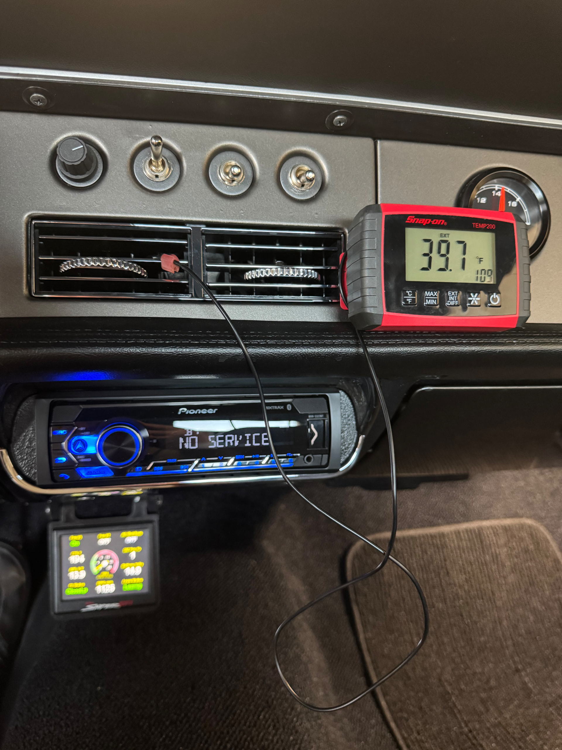

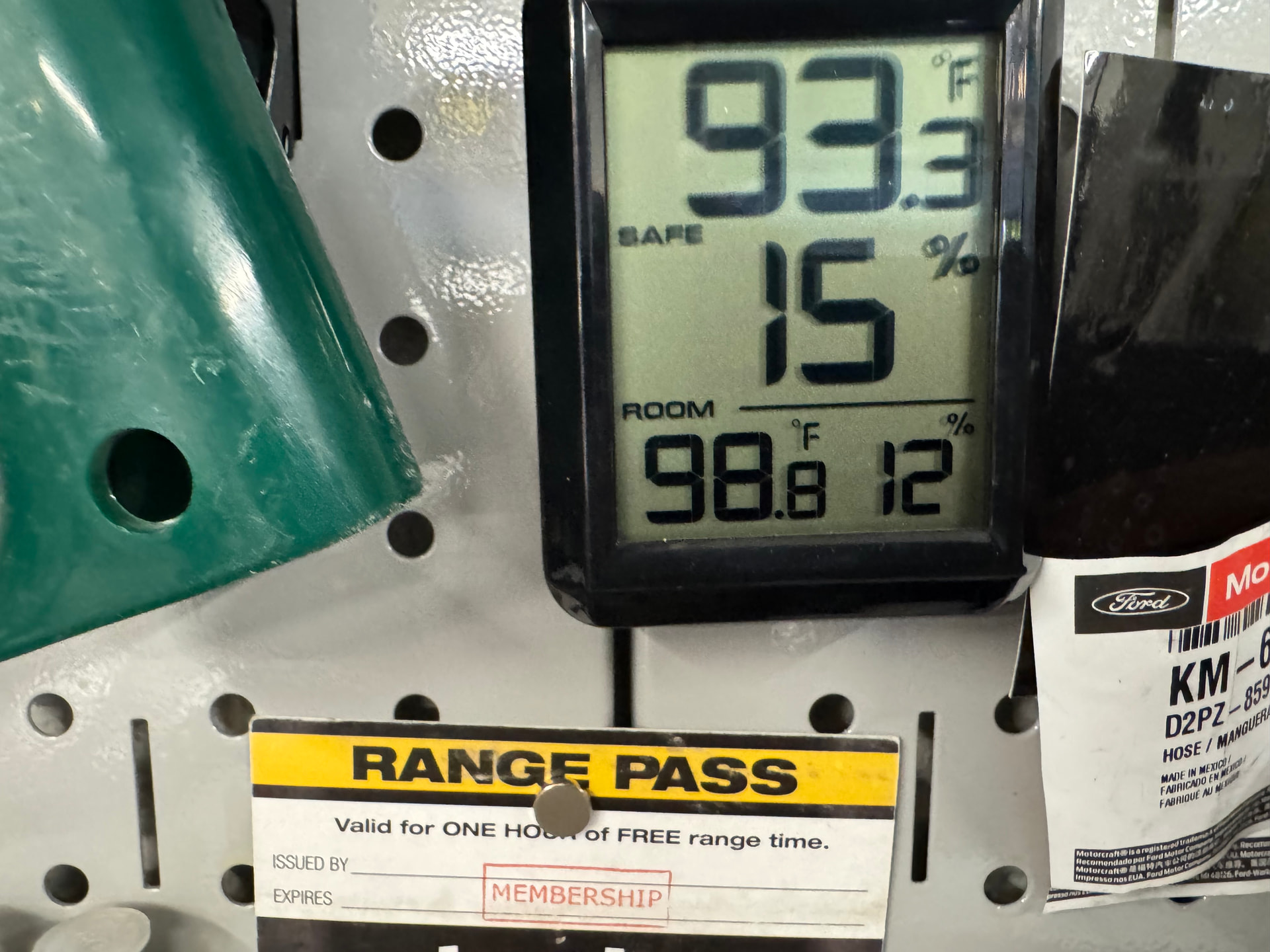

Rechecking pressures and discharge temps I was happy with the results with ambient temps at 98 degrees and about 105 on the road. vent discharge temps at 39* parked at idle. Running fans at 100% to compensate for being parked at idle.
Quick road test confirmed everything was good. I still need to adjust the fans to accommodate the extra heat from the condenser but with the fan controller that’s easy to adjust. Will clean up the wiring and finish the heater hose/valve install over the course of the next 6 months! Overall I’m happy with the vintage air kit. It does have some quirks here and there but for me was the best option for my car without factory air. Is it as good as a factory r12 system? Probably not but for a non ac car it’s worth it.
That’s a really good discharge temp. Best I could get out of mine with a fresh charge was low 40s on 95+ degree day. I wasn’t running both fans at idle full time, maybe that would have brought it down more. Compared to A/C on a modern car the Vintage Air feels a little underpowered on my car, but it’s still way better than having no A/C.
