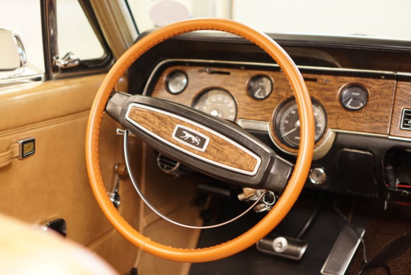

Overall my steering wheel was in decent shape as the rim had been wrapped for a long time. But the center pad looked worn out.
Are there any other instances of Argent silver within the interior that I should be trying to match color and gloss-wise? I think I can match to the glovebox emblem well. Granted it’s aged also.
Overall the wood grain and pad are in good shape. Since it smelled funky, I washed the pad gently in the sink and dried it well. Then I sprayed “Odor Bully” all over it for a few days to get it smelling fresh. Trim ring was the worst piece so got a new one. Plan is to paint both the ring and emblem to be close to factory correct.

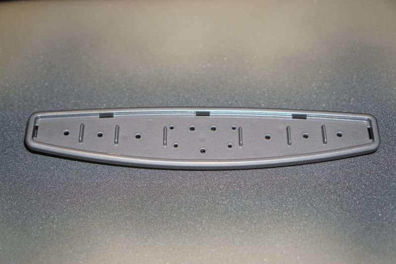

Here’s the paint options I have collected and some sample pucks I made. VHT Argent (far right) has too much metallic in it. Next to it is the same paint with VHT Matte clearcoat. Ford Motorcraft Argent (2nd from left) has less metallic. It’s fairly close but “newer” looking than XR7 glovebox emblem. Adding the VHT Matte over it(3rd from left) tones is down a little.
Here’s Ford Motorcraft compared to the back of the emblem.
Here’s Ford Motorcraft Argent + VHT Matte Clear
Here’s the Ford Motorcraft Argent + VHT Matte Clear up against the XR7 Glovebox Emblem. Kind of thinking this is the way I will go.
Ford Motorcraft Argent itself.
Motorcraft + VHT + Horn Ring (To my eyes the horn ring silver has a bluish tint making it hard to match up)
Motorcraft + Horn Ring

Here’s the Krylon Metallic Aluminum that I was able to find. A shade or two darker than the Argent and better match to the horn ring. I made samples with and without the matte clear but I couldn’t see any visual difference. I’ll prep’ the parts and do some more experiments with the blacks.
Krylon + VHT Matte Clear

Here’s the Appliance Epoxy Stainless Steel paint that I found at Ace Hardware. I’d say it’s one shade brighter that the Krylon and a bit more metallic actually. I wasn’t sure which color to use so I asked my kids. Going to give the Krylon a try. It’s the best match and looks good contrasted with the black I am planning for the inlay.
I scrubbed the emblem and exposed the silver paint beneath. It would seem to indicate that the horn ring has changed shades over the years. Entirely possible or the match of painted metal vs painted plastic was a bit off from the factory.
Appliance Epoxy SS compared to my horn ring.

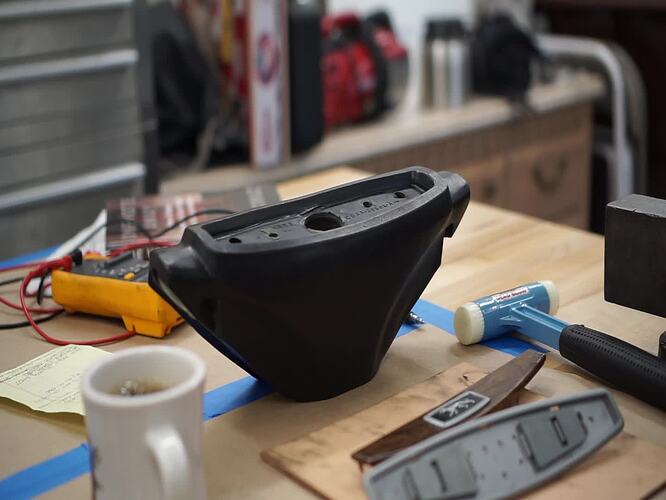

Here’s an update. Doing the black recess was a chore to say the least. Used Testors black semi-gloss. Ended up looking good but it took four rounds of paint/touch-ups with toothpicks and other “micro” tools. These pics are the raw paint and I will clearcoat after 48 hours.
Looking good!
So here’s the final product. Thanks to all for the paint advice and positive comments. I really like the improvement it made. I messed up one aspect however. I never test fit the metal woodgrain piece into the plastic bezel. So of course it didn’t fit. Here’s a video about how I addressed that issue.
