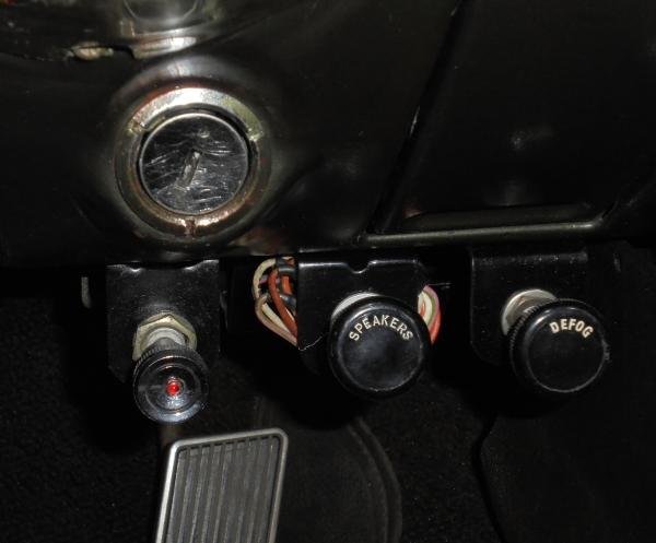

By using the balance control on the 8 track and the fader you can select 1 of 4 speakers. The fader is two mechanically connected potentiometers.

Does the 69 have the same fader options as the 68 ? Does anyone have a picture of that knob ?
I have an odd knob connected to what looks like an old potentiometer on my car that isn’t labeled and I’m wondering if it’s a fader that was either dealer installed or installed by one of the previous owners. One of the POs hacked the dash apart a bit to fit a fancy stereo, but this knob and the solder and stuff seem to pre-date that modification. Maybe the “little old lady” who owned it for its first 30+ years was really into hi-fi despite the AM only radio option :wink:
I’m not sure if the 67/68 rear seat fader was avalible with a mono AM radio, but 69 and 70 it was. My 70 CJ car “had” that option. Some of the wiring is still in the car, but hacked up.
