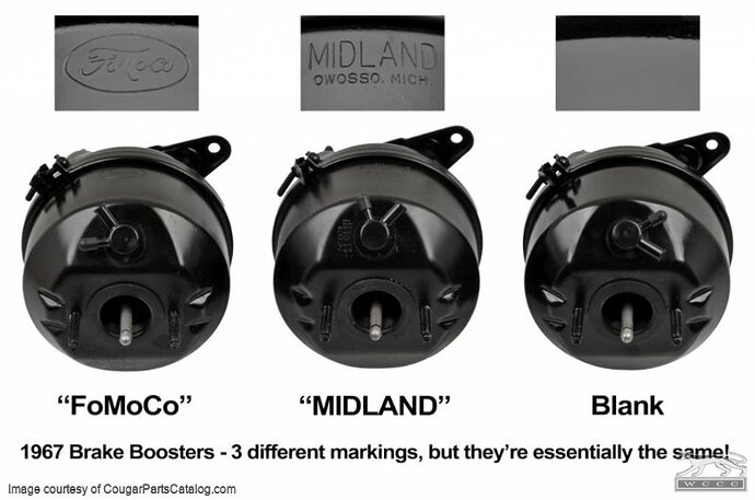

I am trying to keep all stock as much as possible, I did find the Ford logo on the spring perch’s , I’m going to attempt to change the bushings on them. got them from NPD.
That means it is service replacement, original had no logo
I wouldn’t have expected that, the other pair something like LTI on them?
Same as the brake boosters, if your says FoMoCo on a Midland it is Service Replacement.
I don’t know these things , I’ll just have to make my best judgment, I’m not going for date codes and such my intentions are to just change color and engine.
