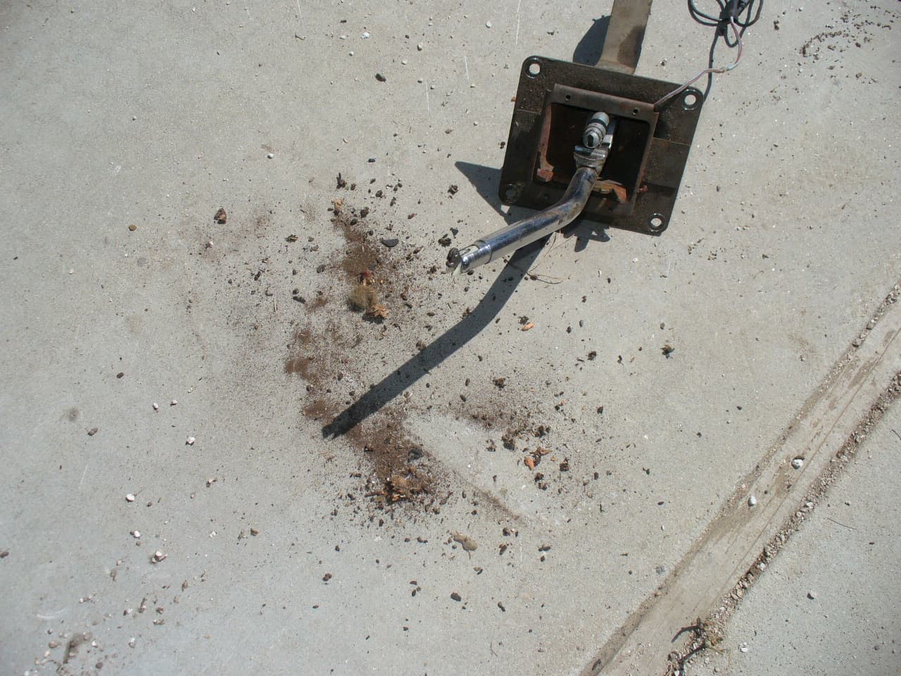

welcome to the forum! A couple of things to look at for you. There are a couple of bushings that are common to wear out, in the shifter bucket, under the car. Also, it sounds like they are worn out to the point that your neutral safety switch is out of adjustment. The bushings are easy to replace, and the switch is not hard to adjust. two bolts, and a small drill bit are really all there is to it. As for the stall, I’m willing to bet there is a leak, in the vacuum advance line. Post some pictures when you get a chance! These are just something to help visualize what I’m talking about-
Thank you! I will look into those bushings and get them on their way, also. Really looking forward to getting it back on the road! I’ll post some pictures once we get it cleaned up this week.

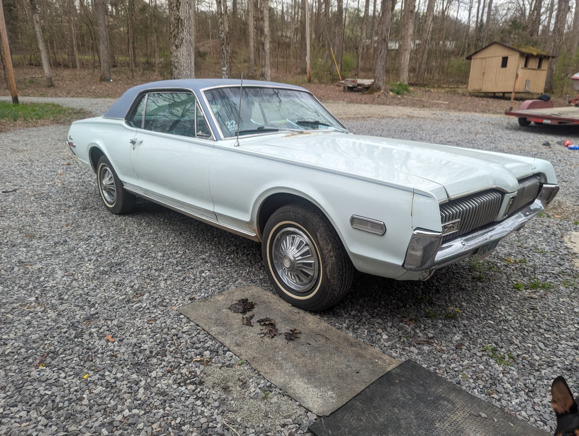

Attached a picture, she’s still in pretty good shape! I can only add one pic at a time.
