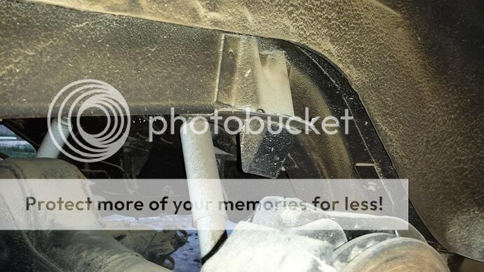

Is it just me?..or is that inner lip between the wheel house and the frame wider than a 67/68 Mustang? My wheels are coming in Wednesday…and I’m not entirely sure they’re going to fit. 15x9" with 6.5" backspacing per the guy I bought them from. I’m thinking I’m going to be needing 5.5" backspacing…particularly considering my rear end is slightly narrower than the stocker (58.50" vs 59.25"). My 15x10 with 5.5" fit perfectly in my last 67 Mustang, which makes me curious what you guys have run with success. In the end though I guess we’ll just have to see.

I fit 5.75 backspacing on a first gen. But that was with a stock width rear housing. That would be about the limit from what I remember. I’m no longer running those wheels.
