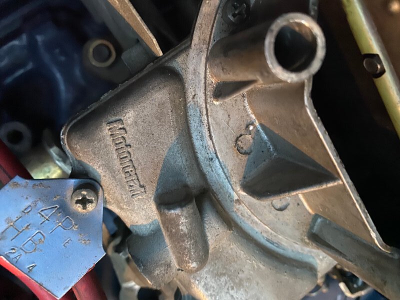

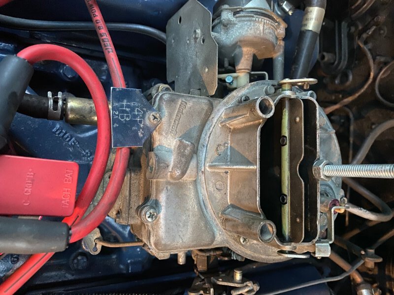

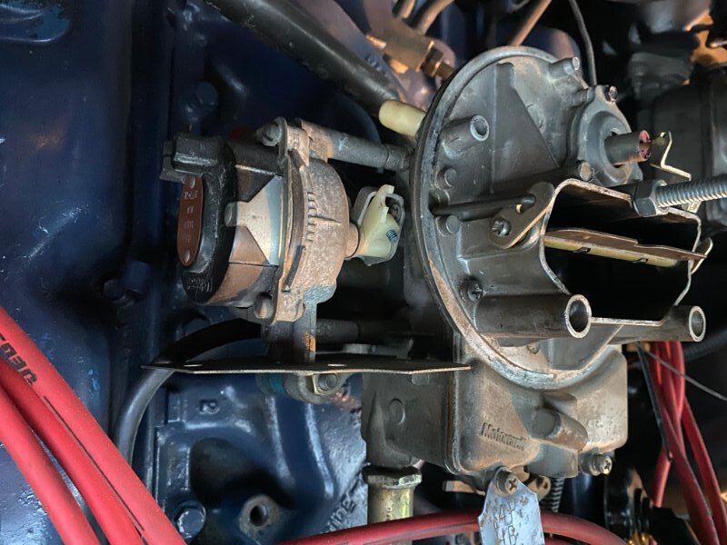

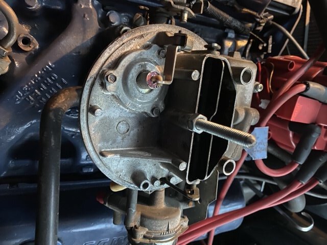

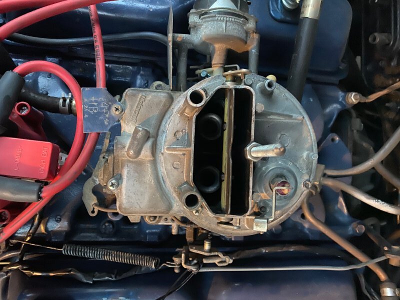

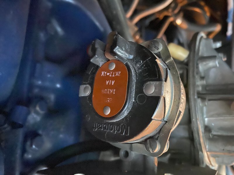

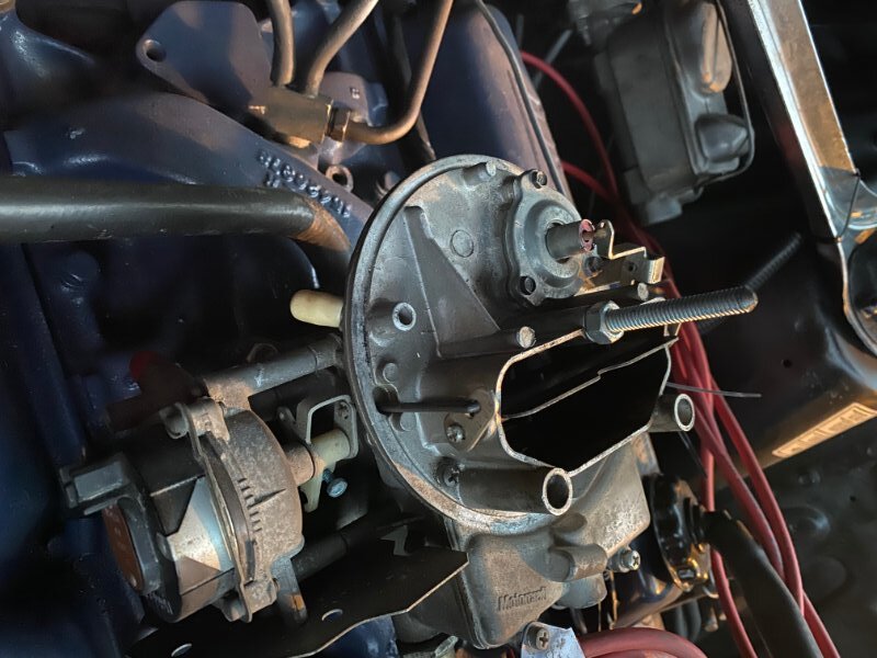

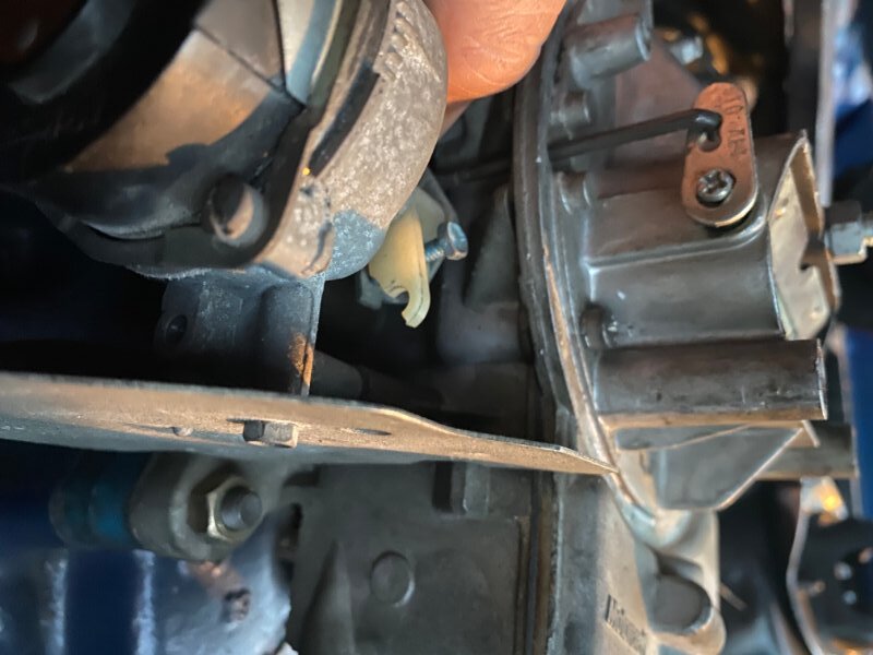

Also while we are on the subject of carburetors, I need a new one from what it looks like. Suggestions please. 289 small block. Pictures below.

Your photos show a mid 1970’s Motorcraft 2V. You don’t say what year the 289 is but in any case it would have used an Autolite carburetor when new. Tune up problems need to be addressed as a whole. With the incorrect carburetor it’s a good bet there are other glaring problems that need to be addressed too.
I see a D1OE Casting number on the intake maniforl just in front of the corroborator. You may have a 302 from a later car. I see you have what looks like an HEI distributor.

That funny device in the rear of the air horn behind the two primaries is the first giveaway that you have a non-original 2100 variant. A parts-supply-chain rebuilt 2100 will be about $250 + core charge or more, or you could get a Uremco rebuilt via Summit for about the same. Uremco number if I have your car right is 7192.

That carb has an electric choke that is not connected. Power should come from the STA terminal on the alternator with a fuse in the line.
Looks like he’s got it cranked all the way lean so that it’s out of the loop.
