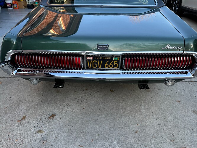

Question for the more knowledgeable cougar historians out there. I am working on my own XR7 and removing a set of hideous square tips that someone put on the car back in the 1990s most likely. The look better on a truck than a Cougar. My question is, what came from the factory for exhaust tips? Did they tuck under the valance with a downturned pipe? I can’t seem to find a good period photo of the cars to determine what was there originally. Any ideas?

Yes on the downturned pipe. Unless it is a G or GTE
CaliCougar the factory 67-68 single and dual exhaust had a turndown that tucked under the valance as you described. I recently added a set of Mustang GT split tips to my 67 XR7 to give it a GTE look after I removed the ugly chrome torpedo tubes from mine.
