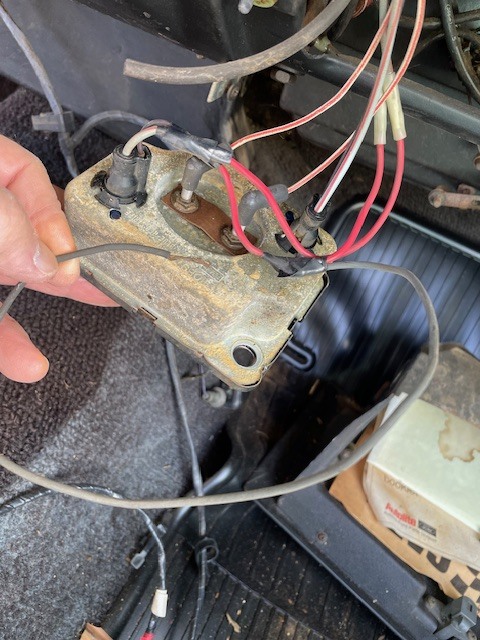

68 Xr7 Oil Guage wiring
I guessing that the black wire held between my fingers does not belong.
Also, do the light bulb sockets just twist counterclockwise to remove?
Any tips, I hate breaking stuff.
Yes, the light bulb sockets just twist out.
The black wire doesn’t look like it belongs there.
Hard to tell from your picture, but is the black wire spliced into the red wire? It does not belong, especially if it is spliced.
Yes, spliced into red wire. I will remove it. Strange, on WCCC site I noticed their replacement pigtail is different color. Interesting.
Wiring Pigtail - Under Dash Harness - Leads to Oil Pressure Guage / Lights - Used ~ 1967 - 1968 Mercury Cougar XR7 ( 1967 Mercury Cougar, 1968 Mercury Cougar ) at West Coast Classic Cougar :: The Definitive 1967 - 1973 Mercury Cougar Parts Source
Looks like the red wires to the light have also been spliced into the original harness.
If you look closely at that pigtail, the wire is white/red as it should be.
