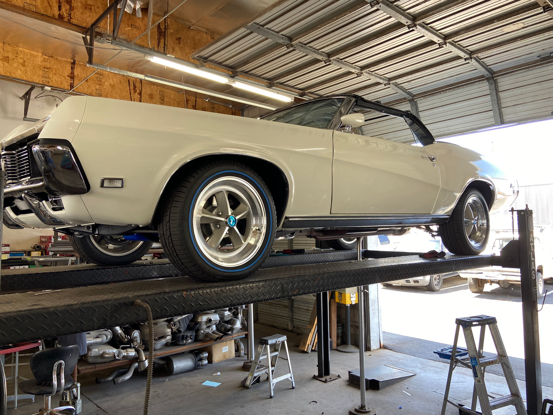

Here is my car getting exhaust and ready for a Top.
Pretty car.
