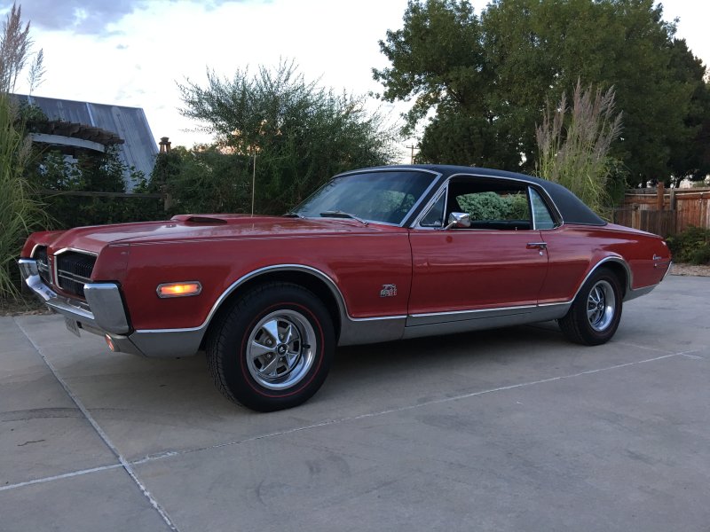

Well good luck finding 100 examples of the GTE!
If you or anyone else is interested in pics or documenting a GTE , 543072 would be a good one to start with.

I was referring to this one.
I’m sure there are finer examples out there, but getting pics.,might be harder to obtain.
Thanks for the clarification. Haven’t spent as much time with the Cougars as with the Mustang/Shelby cars so not aware of the better (for this sort of detail cars) and don’t have the decades of pictures collected from them. Have been blessed over the years since many owners sharing pictures through email, forum posts and even CDs from around the world when they disassembled their unrestored cars. This has helped clarify the details I’ve been able to collect through wrecking yard, restoration shop visits and inspecting cars for purchase and restorations.
