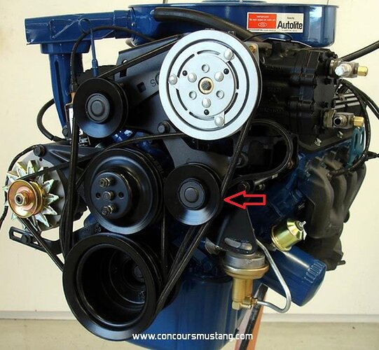

Pix I found while restoring my AC to working condition. he Red arrow points to a Pulley you don’t really need according to input from the board I received. I’m running without it.
Mike M.
Thank you! Now that is helpful. I scanned the entire shop manual and didn’t find anything showing the pulley set up I’m sure it’s there somewhere.

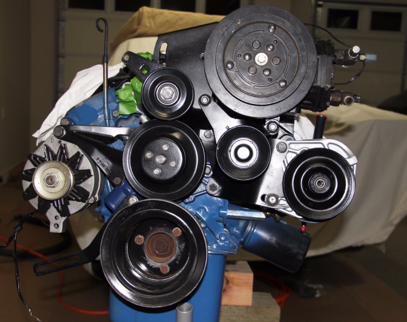

Here is a photo of mine. 69 XR7 with AC and PS.
You have AC… but no Power Steering???
Wow.
Funny, but we swapped from a C to a W into a 72. Much cussing and discussing occurred and various bracketry for the PS was confabulated. Fyi, the Brackets are different… sooo close, but different. Haha.
