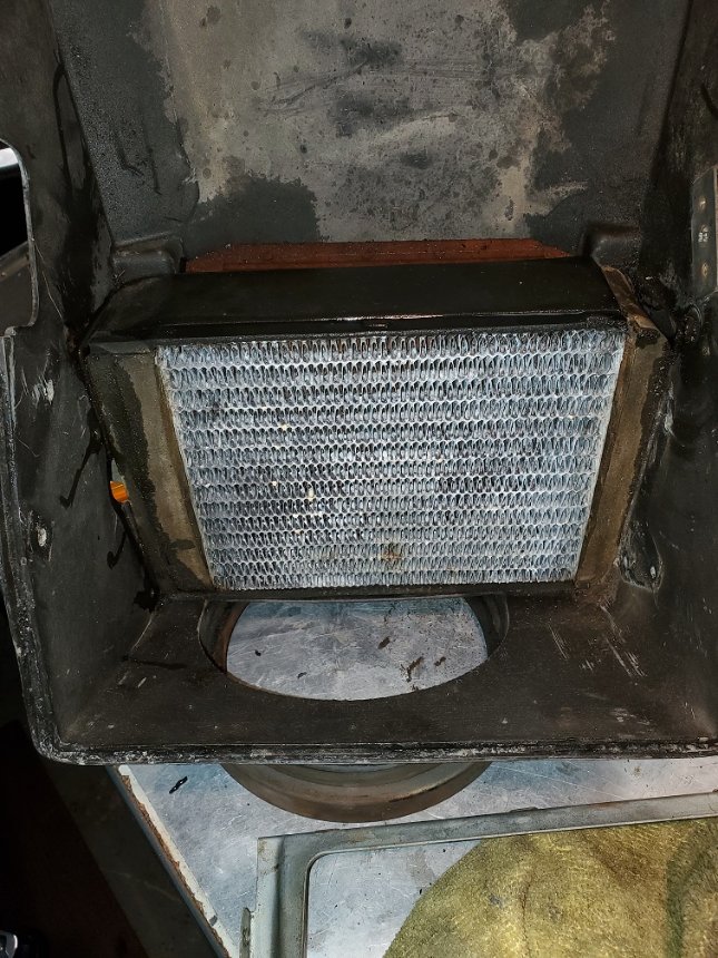

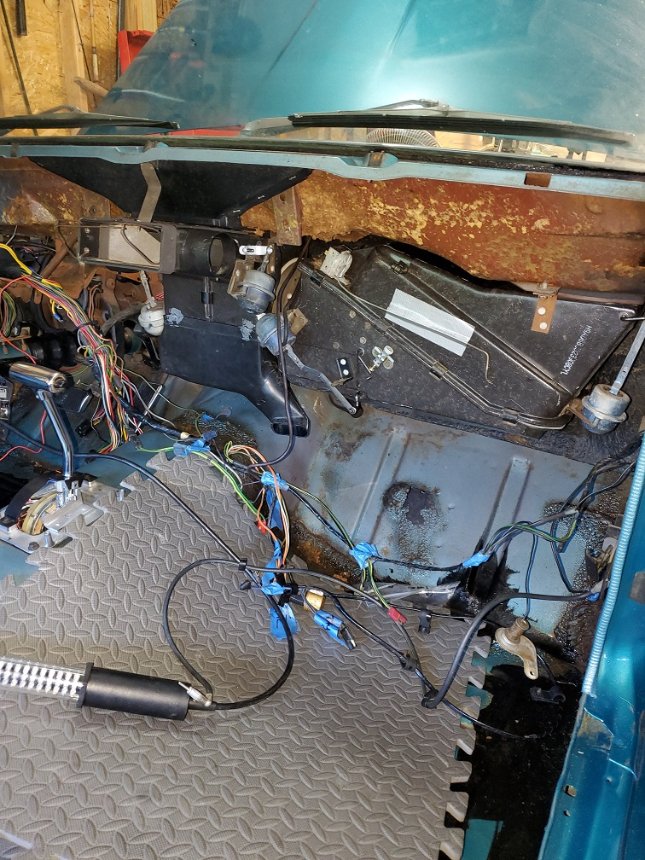

Heater Core, They send that down the line and build a car around it! :laughing:
And here I always thought that removing the cowl was the worst job!
I have done all three, but if I had a choice the booster would be easy one.
what makes the booster a pain is fooling with the M/C and lines.
i have to admit, I haven’t done a Cowl. I think the 67/68 are much harder than my 69. all I can say is don’t schedule any thing else the day you decide to attack a brake booster. Heater Core, Watch the video about 12 times and give yourself a week.
