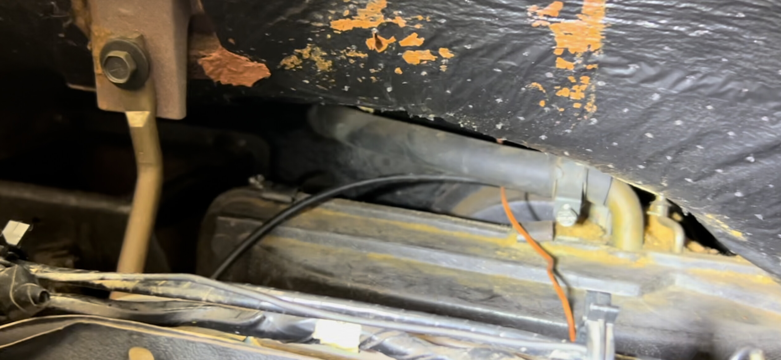

Here is a look with top dash/defrost deflector/tube(?)removed.

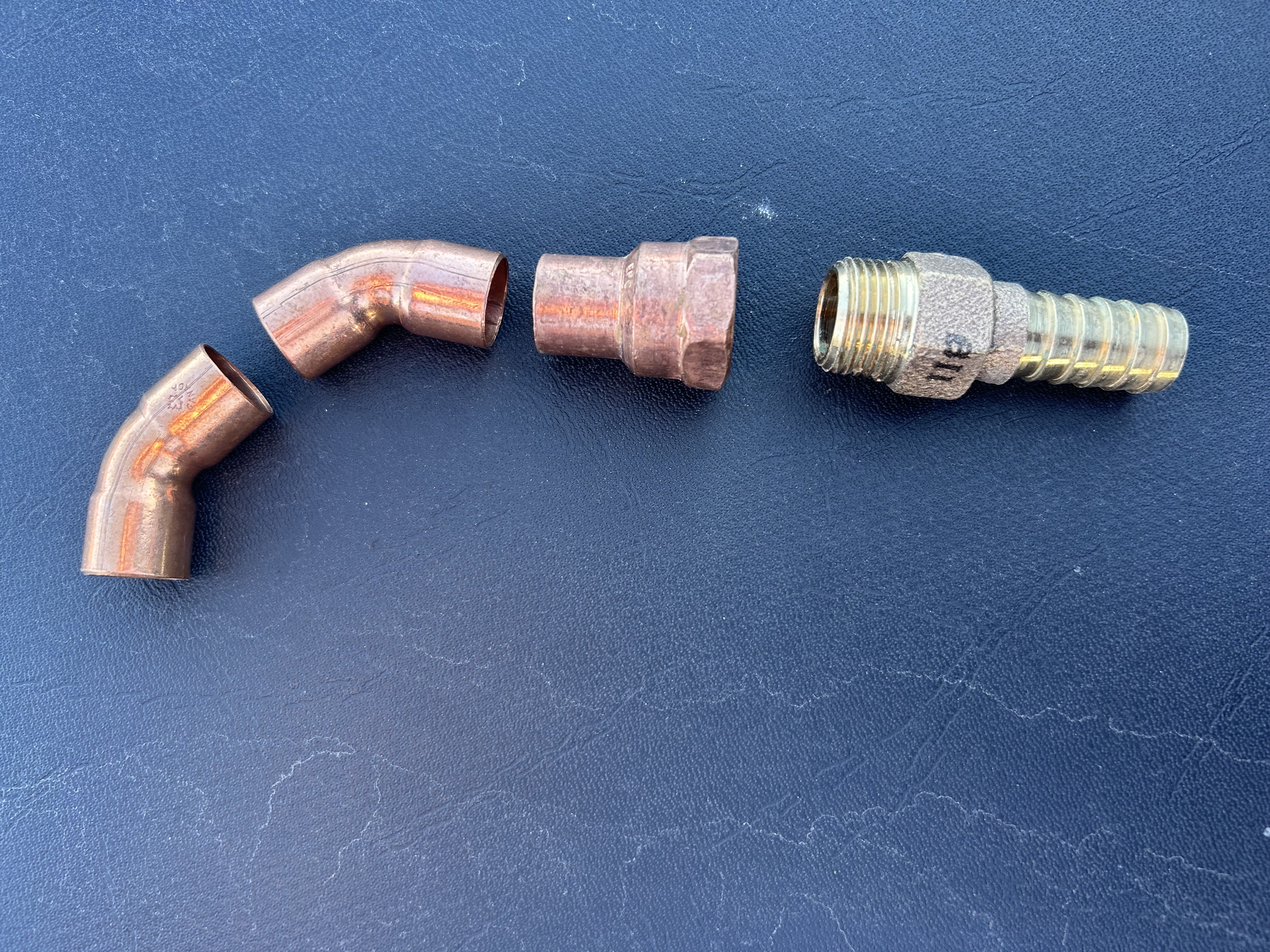

You can change hoses with just the top dash removed. In theory, copper pipe & angles would work. Here is what we played with:
Using copper pipe to run the length. Ultimately we could not get the pipe through the firewall to cleanly solder it to the female end (see the slight upward angle). The other option was pushing the male end thru the firewall into engine bay. There was not enough room between core and firewall to make that happen.
Just having to pull upper dash made the decision to attach as engineered easier.

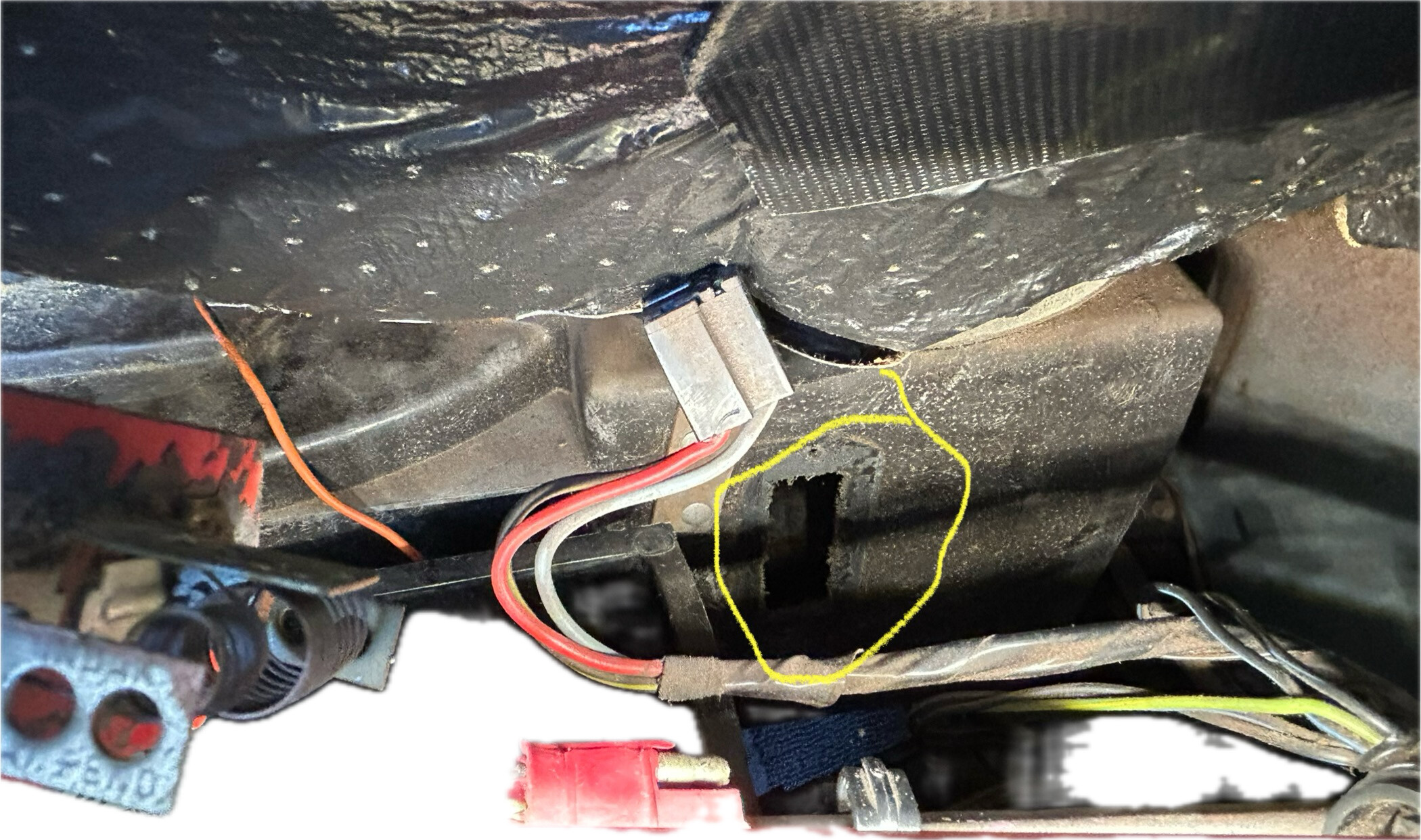

Closing this one out. You can access the air intake box by removing the resistor circled (that may cause leaves to burn) and shining a light in. Mine was shockingly clean.
