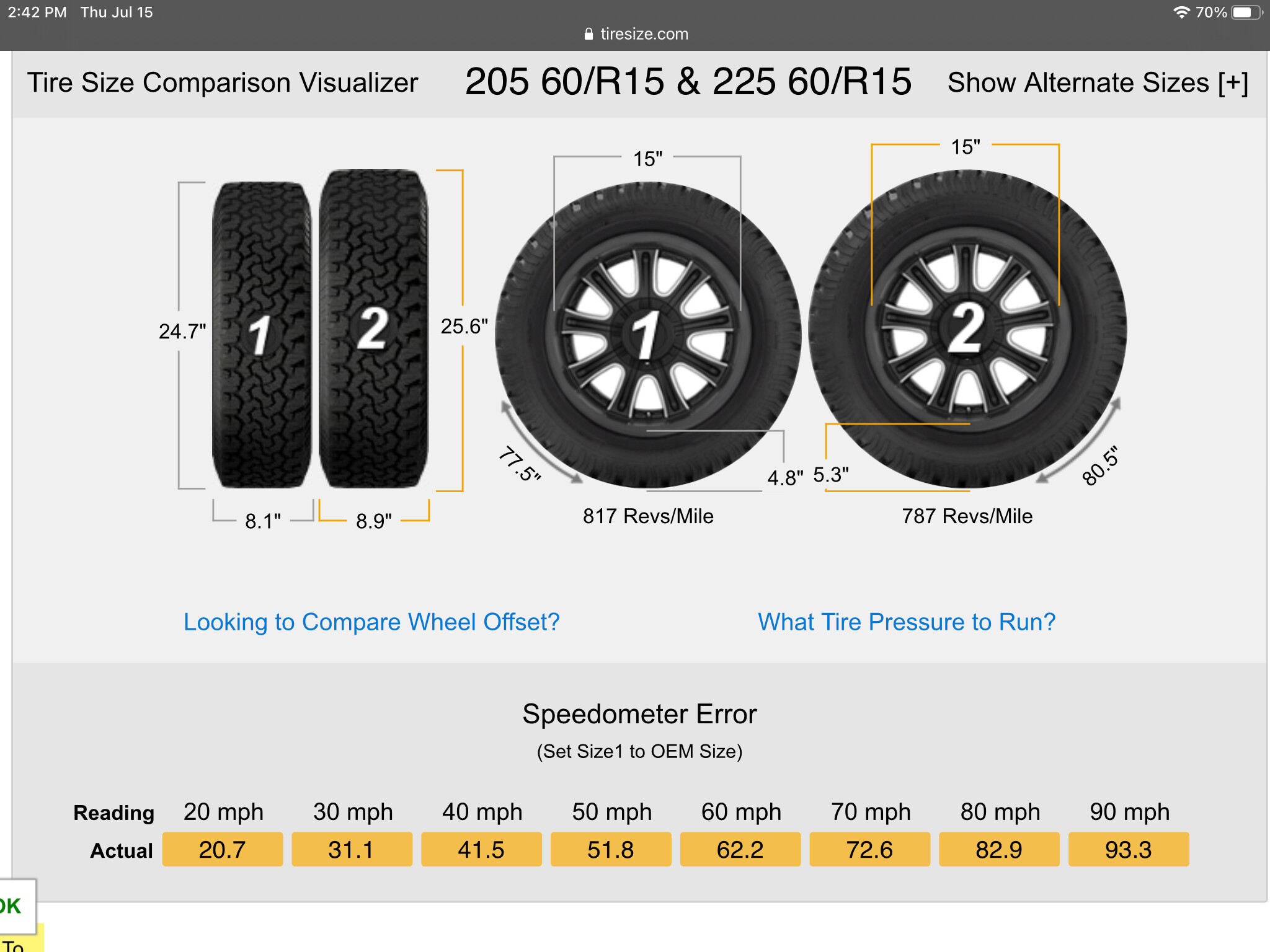

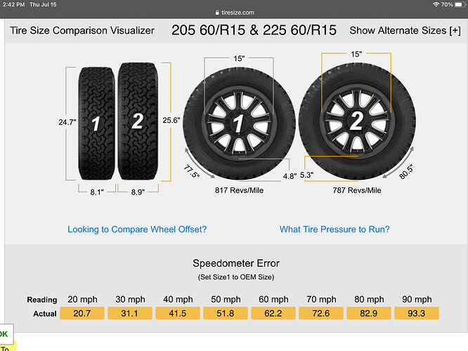

I run 215/65 and have had passenger fender scraping… Here is a visual on your 60 ask… website is tiresize.com
