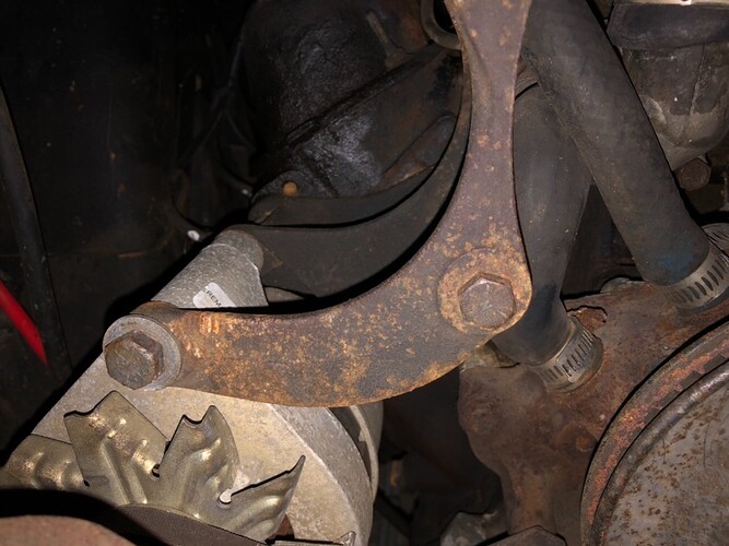

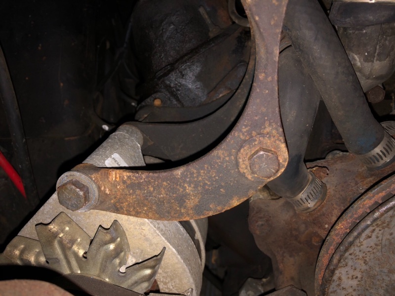

A little thread resurrection here: I’m in a similar situation with my ‘69 351W/FMX/factory A/C Base Cougar.

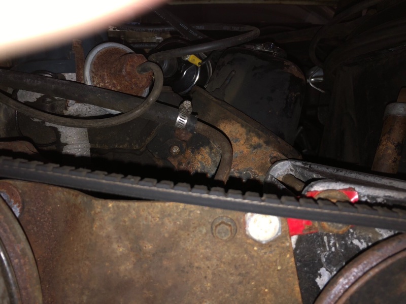

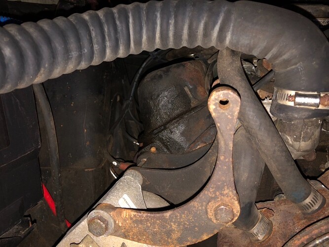

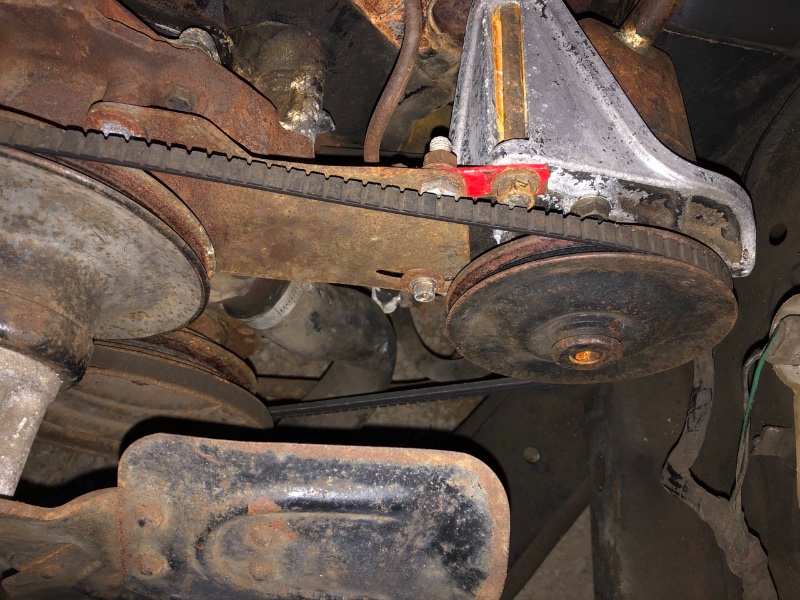

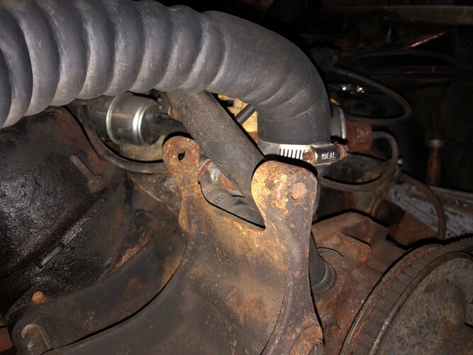

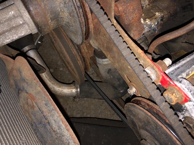

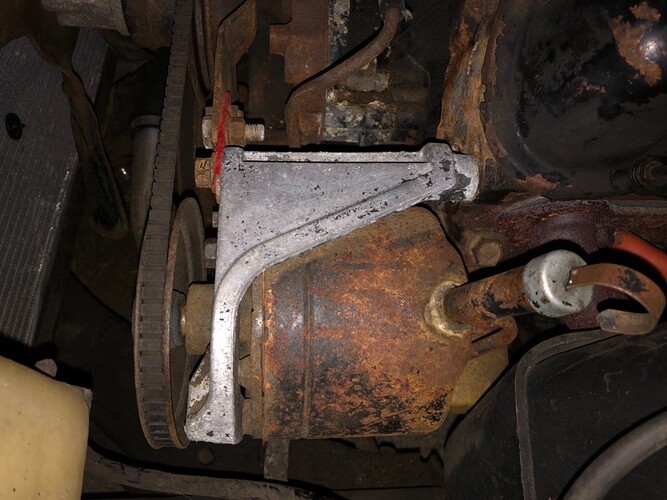

The prior owner pulled the original 9.48” deck 351W when the oil pump let go and spun bearings. According to the PO, a friend had a 351W (should be a 9.500” deck) from an early ‘80s F-Series that is now living between the shock towers. They didn’t bother to swap the front accessory drive over, they eliminated all of the underhood A/C components and brackets, they didn’t swap the water pump and didn’t bother to hook heater hoses up. I’m now trying to undo this stupidity. :wall:
jrainey4, What configuration of brackets/idler pulley are you running? I’m thinking I need the C9OZ-2888-B Lateral Support Bracket to not only mount the A/C Compressor, but also properly mount my P/S pump. It’s the original ‘69 P/S pump with a combo of ‘69 brackets (pump side), ‘80s truck brackets (engine side) and a home built extension tab that puts the pump’s adjustment pivot and the adjustment slot in 2 different arcs. I can’t get the P/S belt tight and the pulley alignment is jacked. What idler pulley do I need?
I have a correct timing cover and RH inlet water pump that came with the correct alternator bracket/adjuster so I’m thinking I only need the little cast offset/stand-off bracket C9ZE-10A336-A to button up that side.
I also have the correct 2 sheave crank pulley for a ‘69 A/C 351W.
I’m wanting to set up the front accessory drive minus the A/C compressor and components so I can cruise the car this summer (Power Tour ‘21 the end of August is the goal) and finishing finding the A/C stuff and refurbish the interior A/C components over the winter. I’m trying to buy the parts I need to do this right once and keep moving towards the end goal without buying parts I’ll only need for a few months. I’ve attached photos of the mishmash of pieces-parts of what I have right now if anything attached to the engine is ‘69 parts.
