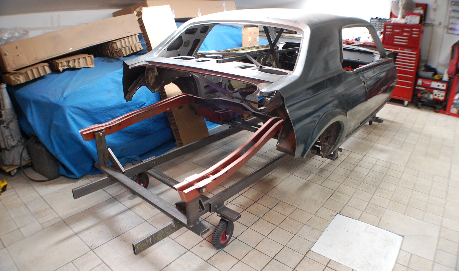

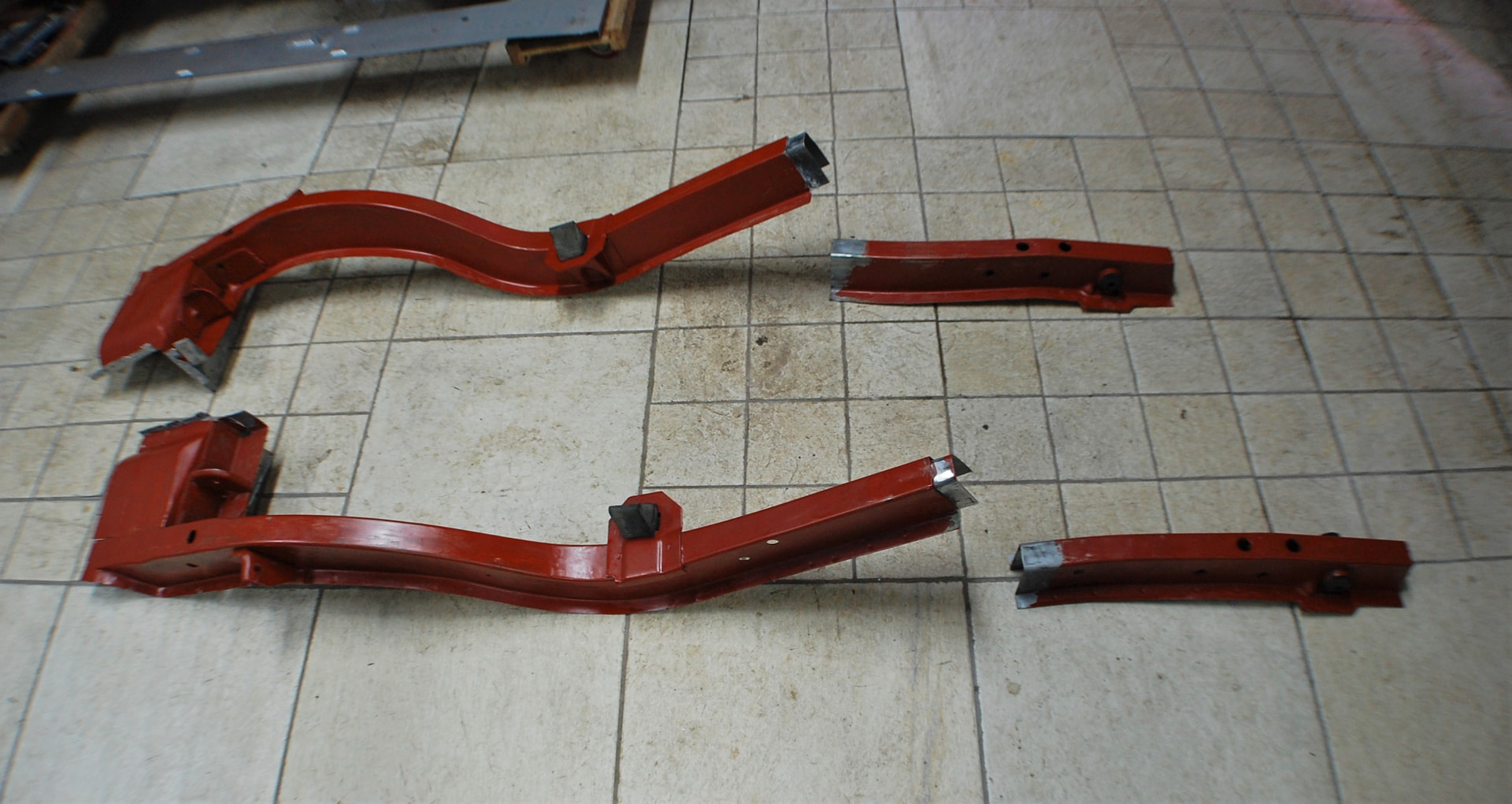

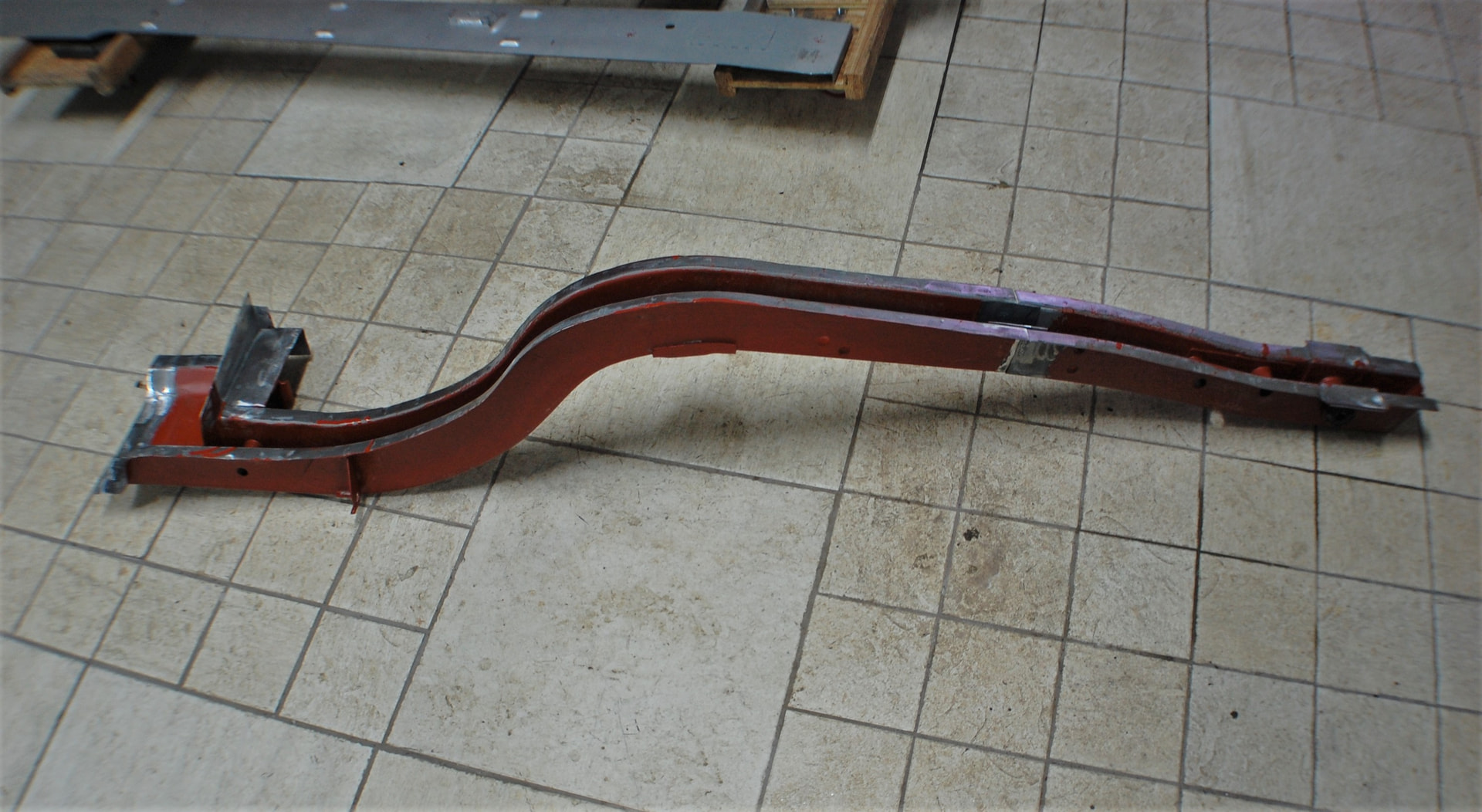

I had the same issue with my 67, so first I sandblasted them from outside and they look pretty good but when I finally removed the trunk floor the inside part of the rails where worse than the outside.After that I was looking for frame rails, nobody made them, so I ordered two mustang rails and I said that I would modify them to make them Cougar; it turned out that I wasted $1000.So my last option was to order them from WCCC and clean them and repair them since those I received were in very good shape but not perfect like any used parts.It’s a costly task but at the end the results were excellent.I ask WCCC to cut them to save $400.00 in shipping since the uncut ones are oversize.I just had to make a splice and reweld them together.Good luck
Here’s a picture after reinstalling them in the car.
Hi mike289 Thanks for sharing the pictures they look really good and you did a nice job on cleaning and welding them back together. Thanks for the tip on having them cut $400 is a good saving for sure I have no problem welding that for sure.
