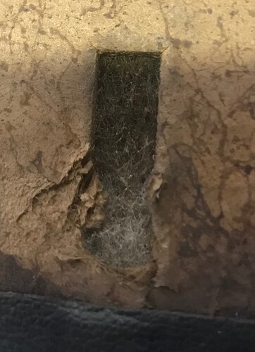

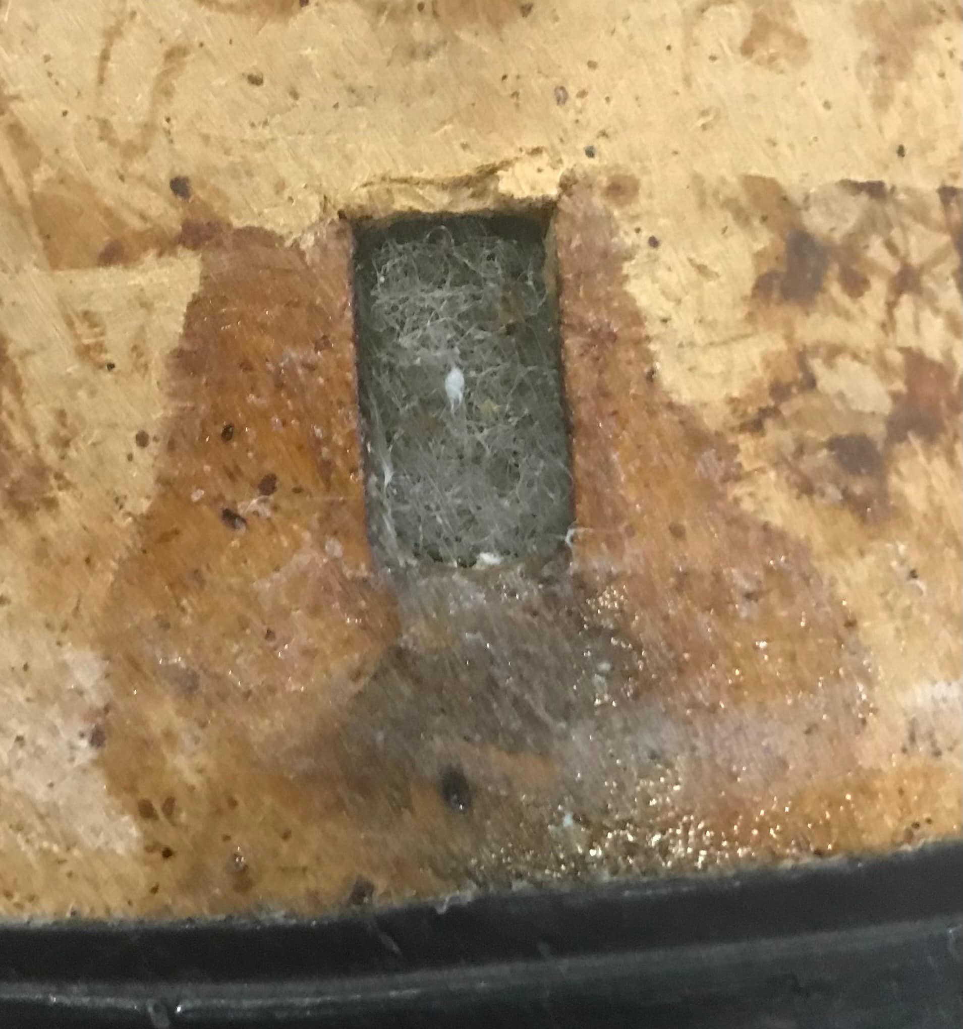

Are you replacing the backboards because the clips are torn out or the boards are warped? You can fix torn out backboards with dust from sanding the backboards and super glue. Way easier.
to help w/ this issue I have used a thin piece of steel ( like strapping steel) slide into the holes, then the clip has reinforcement to hold onto. There 2 ideas work wonders & take little time.

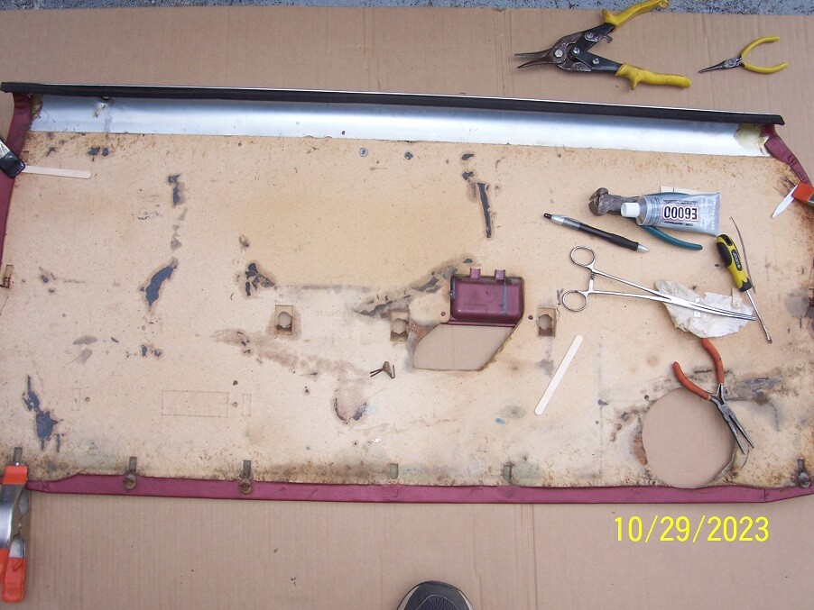

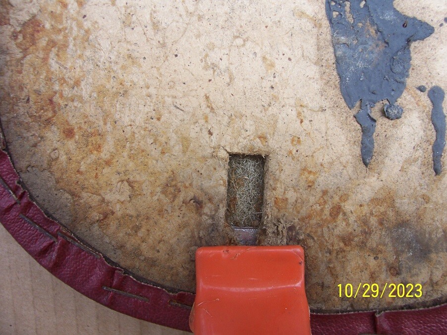

Thanks again Bill! I love the idea of the banding straps, I just didn’t feel like taking the run to Lowes to snag some from their lumber department; bet I will next time I’m there! In lieu thereof (I had been thinking about popsicle sticks - too thick, or balsa wood - too thin) I had some fragments of 2x6 steel stud laying around and cut myself some slips 5/16" x 3/4" and slid them inside the panel with some E6000 sealer, then put a pinch clamp on each one. They aren’t “tried & true” yet, but I like the looks!
