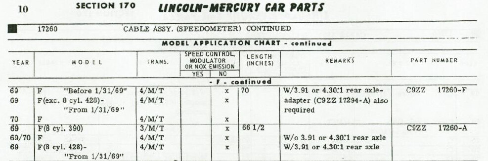

Looks like the cable is either 70" or 66.5" depending on your build date ( before or after 1/31/69 ). Have a look at the following chart from the MPC:
Looks like my car should take the 66.5" build date was 4/25/69
Thanks so much!!
