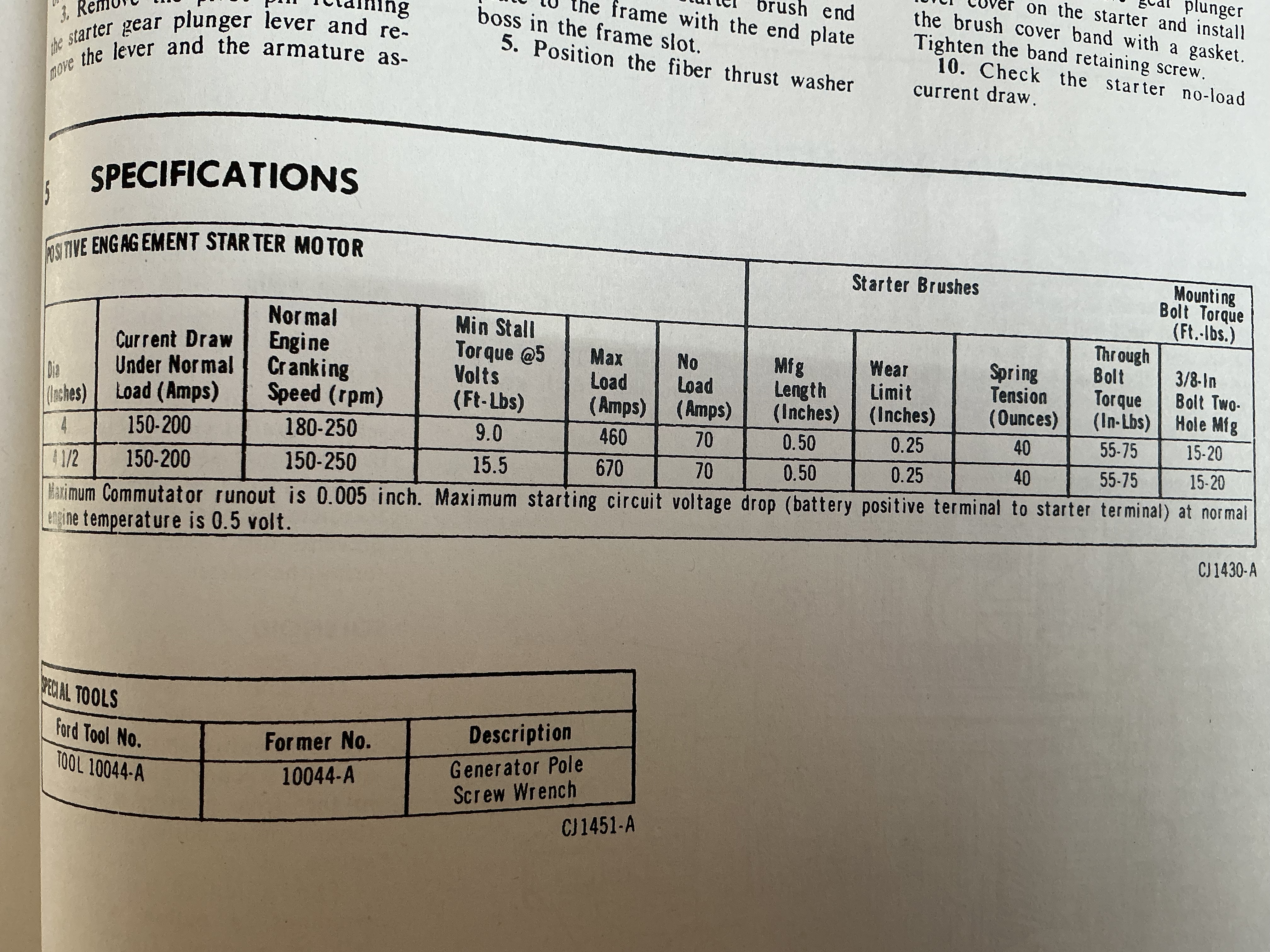

Also, if you know someone with a DC amp probe, check how much amps the battery when cranking. That will eliminate a lot of guessing. Starters can take a lot of crap, as evidenced by my '72’s original one that still functions properly today. Proper power system distribution should isolate the starter. Most solenoids on the market are only good for 30-40 amps DC. If you buy a Cole Hersee 100 amp, it will be a plug and play answer.
Even 100A rating on the solenoid would fall way short. Our starters are rated at 150-200A under normal load, and 460-670A at max load. That’s why batteries are typically rated at over 500 cold cranking amps.
