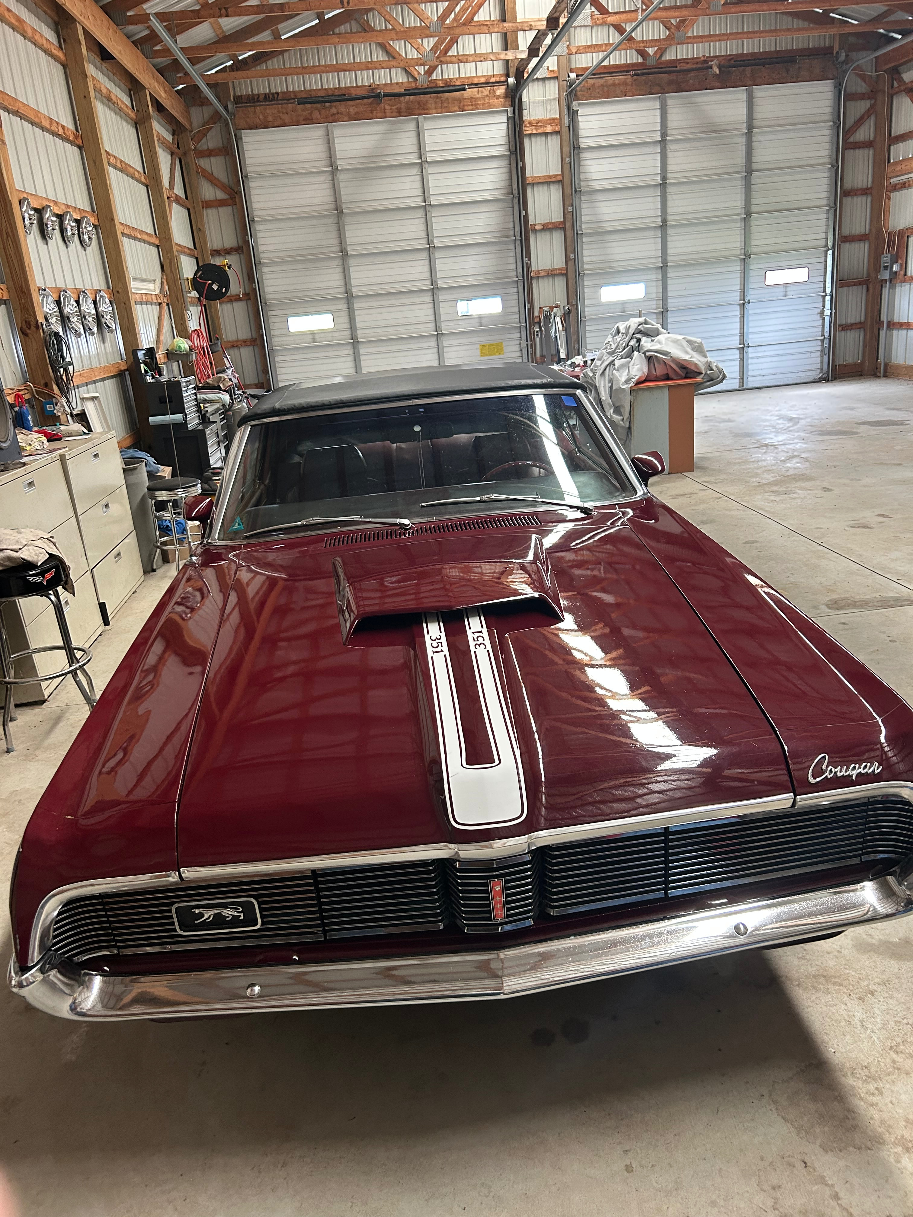

BEAUTIFUL. Love that red, and the stripe. What is the red called???
What is the color of that red?
What did Ford call that color??? Sorry…
Mercury Maroon?
Thank you!!!
Looks like the “Royal Maroon” on my 1969 XR-7. Paint code B / M3059. With the black vinyl roof and white leather interior it is very sharp looking ( same color was available on T-birds and Mark III’s ).
