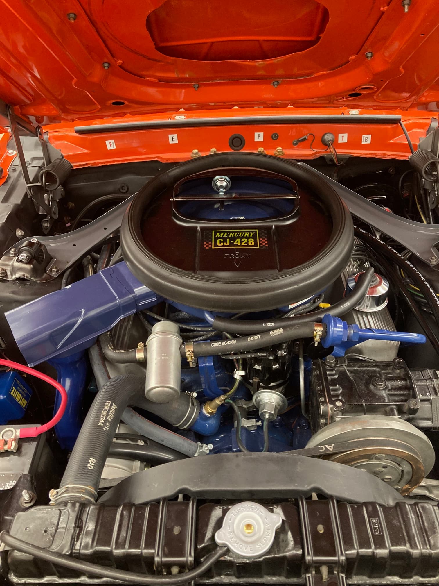

The air cleaner is something like 2 1/4" away from the hood. That space is occupied by the flapper top and the seal. Yours is missing? No way the stock setup will do that.
If your asking is where the top side of the hood and the hood scoop meet, no there was not a gasket. I have seen a couple original hoods that had a scoop on them and you could feel a indentation where the edge of the scoop sat on the hood. As well as one I had painted and put a scoop on.
The one in my photo has an original hood, scoop, air cleaner, ram air plate and seal.
