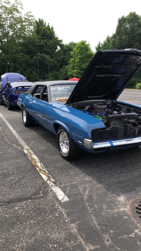

Hello all! I’m hoping someone can assist, as I am new to this forum. I have my resto-mod 69 and I am trying to find replacement bushings for the lead springs. I would like to have polymer bushings, but a kit for the cougar seems near impossible to find. Does anyone know if the bushing sizes are the same as a 69 mustang. From what I understand, the leaf springs themselves are different but I wasn’t sure if they used common bushings. Any guidance would be greatly appreciated!
