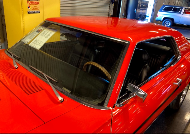

Don so are you in agreement that the mirrors I posted from the eBay link are not something you’d use? I scoured your site for a matching passenger side to the one I have on my drivers side. It looks like this. Any help would be greatly appreciated.
69 Base Passenger Side Mirror

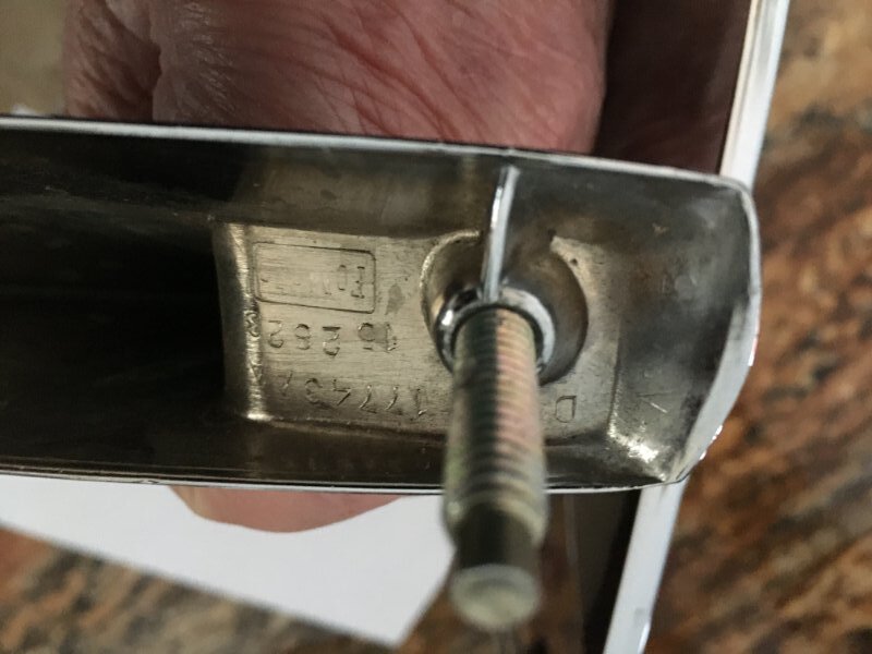

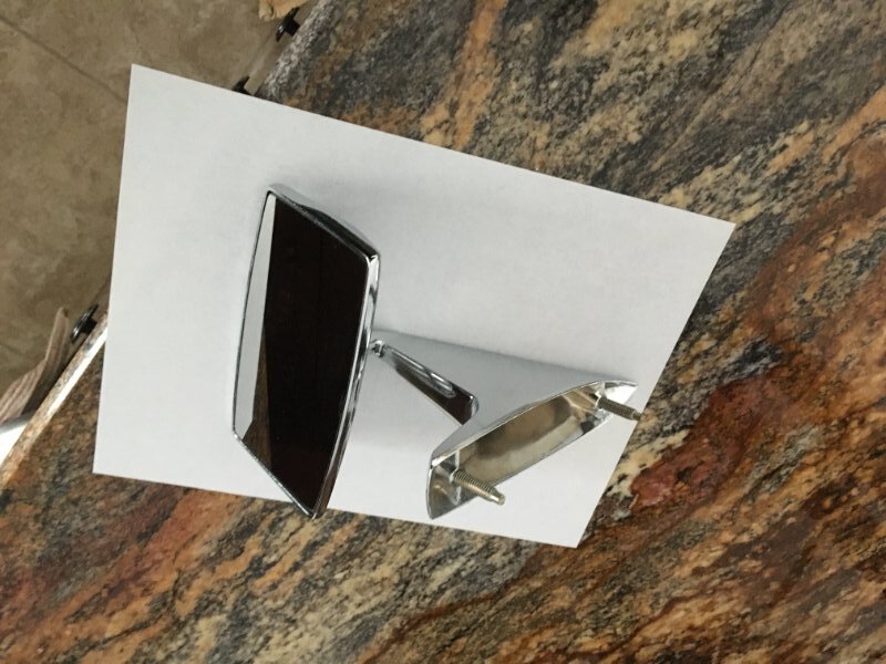

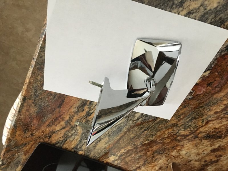

I have a passenger side mirror NOS not sure what year it is for.

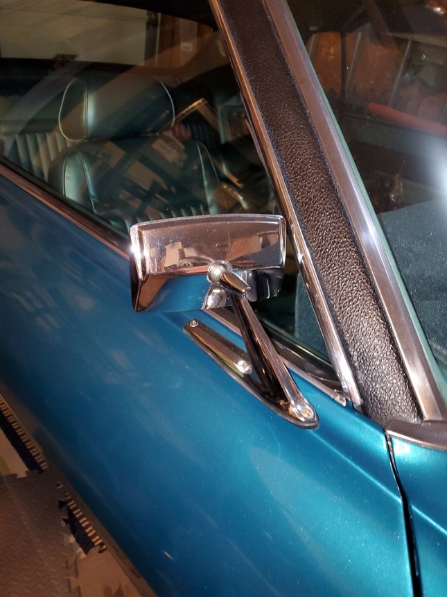

I have become too dependent on having a passenger side mirror. I wanted a chrome one to match the driver side (which never happened on 69/70 passenger mirrors, only color-keyed sport mirrors), so I went with a chrome one from a 69/70/71 Torino (72 and up won’t fit). They use the same mounting bases as Cougar. Photo isn’t great…but you get the idea.
Is it a perfect match? No. Is it factory? No. But, it fits great on the “body ridge” I just had to have it.
You can make it work on the PS but the DS has a unique stamping that will only take the factory mirror.
